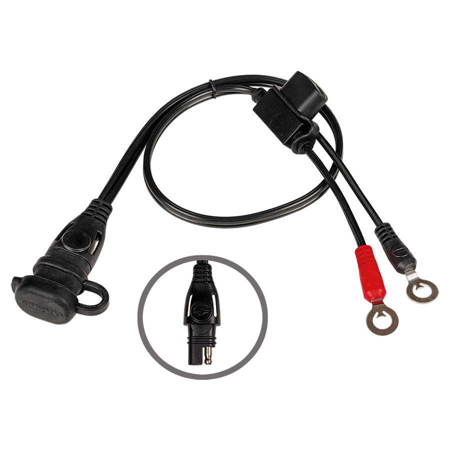

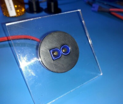

There was some recent discussion about rear bulkheads and different methods of creating a pass through hole for things like wires for trickle chargers and ground power units. My understanding is that the best thing for the structural integrity of the plane is to not weaken the rear bulkhead with holes of any kind, and if any holes are made they might need proper doublers, engineering of which I am not qualified to determine.
I thought that maybe a better solution would be to route the wires under the baggage area floor, bring them up through one of those aftermarket storage boxes. https://fairings-etc.com/products/r...FzdjyDfBk_DTex2d1F6jUhM6SGLLsBKFPAy-69zkflrdn
But I worry that routing things under the floor could interfere with the action of the rudder cables.
For building an RV10, what might be the best possible solution for adding an accessible GPU/trickle charger route? How would you handle this in a new build?
