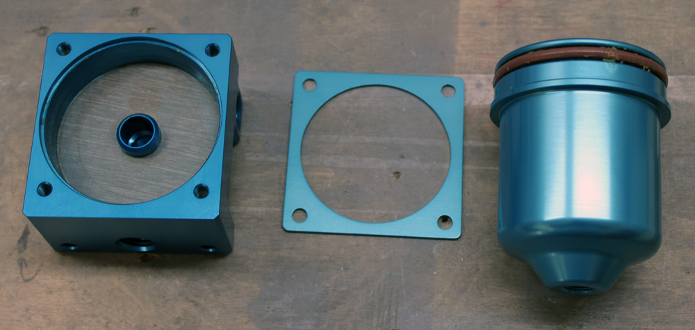

Have you removed the blue fitting from the bottom of the tank? You won't see the strainer (coarse "filter") until you do. It's attached, and inside the tank.
The fine "filter" is a very fine mesh screen inside the gascolator, as Scott mentioned and showed in his post.
There is no separate "fuel filter" as you might expect to see in an automotive installation. The strainer in the fuel tank is to catch large debris there, before it gets into your fuel lines and potentially causes a blockage. The fine screen in the gascolator is to catch smaller particles. Neither one will block everything. If you get a batch of bad gasoline (which can mainfest itself as a nasty brown sludge that smells like varnish) it can be squeezed through both and make its way to the carb where it can and will wreak havoc. Gasoline can and will go bad all by itself just sitting long enough. How long? It depends on temperature, humidity, ventilation, quality of the gas, and possibly planetary alignment or the frequency and sincerity of burnt offerings made to the aviation gods.

Other than the course finger strainer that is screwed into the bottom of the fuel tank, and the fine screen inside of the gascolator, there is no other fuel filter. That is why you can not find it.
There is a very small filter inside of the engine driven fuel pump, but that is not accessible.
I have a feeling Daniel never saw the fine mesh filter screen in the top of the gascolator because he has already posted that when he checked it there was no filter in it.
The gascolator doesn't have a filer element in the can like you might expect if you have only worked on trucks.
The filter is a screen in the top like shown in the photo that mike already posted.....
One more little tidbit--------this gascolator has a third fuel port that needs to be plugged. As I recall, there is one inlet, and two outlets. You choose outlet best fits for your mounting situation, than plug the other one. Some have a primer line port also, see thread below.
The inlet is the one that goes to the center of the bowl, if hooked up backwards, the screen can plug up rather quickly.
If by chance the lines are hooked up using both outlet ports, the fuel will pass straight through, and no filtering will take place.
