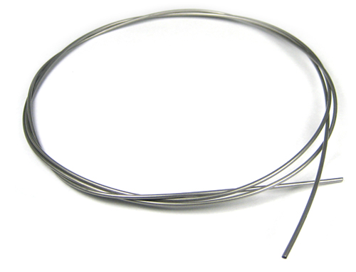

Good Morning:
I had difficulty lining up the “loop” at the end of the CT A-740 Black with the hole and the cotter pin. While attempting to open the loop to make it larger, it broke. If I rebend it, it would be behind the hole. The M341M was nearly fully extended when I was assembling everything, but the F-1210 was up against the cushion clamp. The red area shows the location of where the wire broke.
Can the wire be replaced without purchasing the entire CT A-740?
If it's Bowden Cable then the wire is available by the foot. Ensure the diameter of this cable is identical but this looks like what you need. (You'd have to research how to replace the knob on the new wire.)
