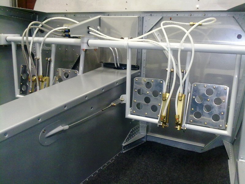

For those of you who installed the Bonoco brakes, does their kit include a wholesale replacement of the lines? or is it simply the lines that are rudder pedal area.

Rudder pedal area. I'm sure Brent would be happy to sell you additional hoses for that long run through the tunnell and under the seats. Bending the aluminum tubing was a little tedious, but not all that difficult. If I can bend it correctly, anyone can.

I bought the -D valve and mounting kit from VANS. Had the bracket and valve fitted in about 30 minutes just last week - including drilling out the old bracket.
The kit comes with 90deg fittings to provide aft facing threads for the hoses to the pedals.
Not a cheap option but it all seems to go together nicely.

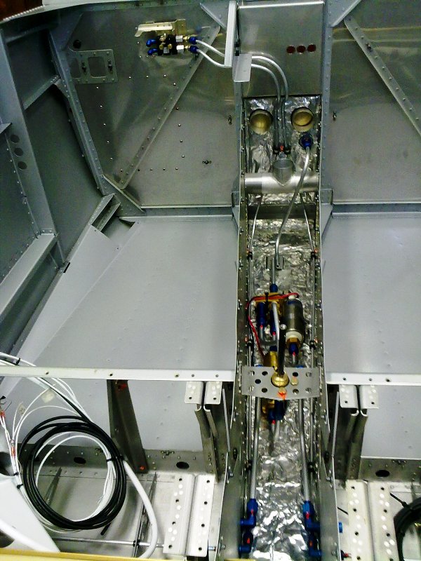

PVPV-D PARKING BRAKE VALVE
These photos was not meant directly to showcase the PVPV-D installation, but you can get the just of it.
I drilled out the normal bracket on the Firewall and modified it for the Push Pull Cable bracket. Then like others I fitted the Carb Electric Pump Bracket (I'm using FI Pump) on the firewall as backing for the PVPV-D.
All the rest of the lines are normal Alu Lines and Plastic. I did replace the Nylon T at the reservoir with a Brass T.
Here are the non specific pictures...
