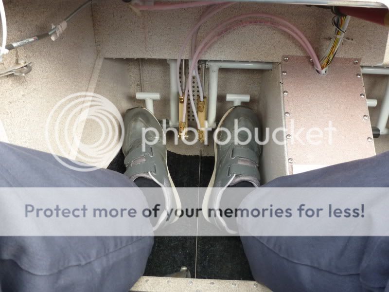

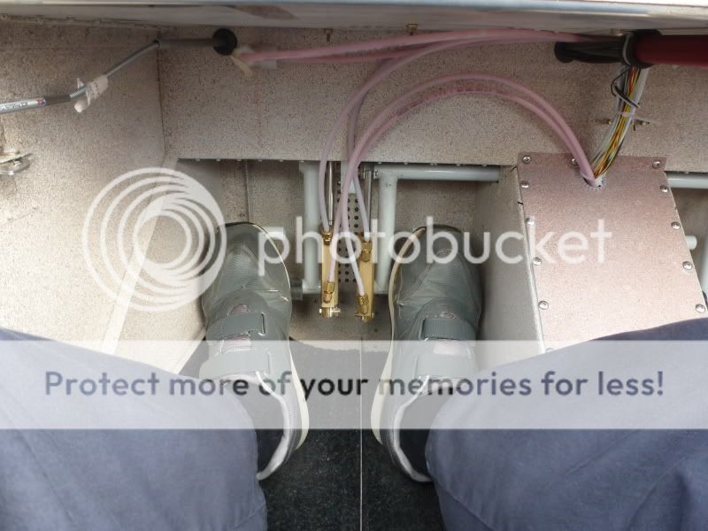

Was flying this morning, remembered - -
Went flying this morning. Remembered to take these pictures for reference. I am 6' tall, and have the seat back far as it will go. I have both provided cushions in seat. The brake pedal position works very good for me.

Imagine this scenario!
John that looks good for you but imagine your heels resting 2 inches higher and then extending your leg all the way to the firewall and your toe would naturally move forward of your heel. Flightline interior carpet would lift your heel up to this height.;)
Apparently - you have not been paying close attention - - -
That is my "HEATER DAMPER DOOR" control. Go back thru the search if interested. Yesterday it was 27F in Iowa, and the heater works great. Nice of you to notice ! !
