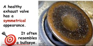

This is very timely. I just watched this presentation by Mike Bush. I, like most of us that work on our own airplanes, believed that compression was the final decider. Watch this video and learn why the FAA has done away with that requirement. Instead borescopy is now the method to determine valve health. There's a chart that shows what good valves look like and valves that are about to fail. l think your valve looks pretty sick. But watch the video and you decide.
Boroscopy
Great video. The irregularity of that valve’s surface coloring concerns me. But to be able to send images to Savvy would be worth the cost of their analysis. I also see a new toy, I mean “tool” to add to my arsenal in the shop.
