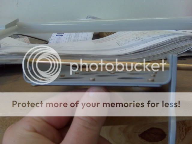

Brake return springs?
Phil,
Great job installing the brake lines. I'd like to know more about how you installed the return springs on the brake master cylinders. I now many have problems with dragging brakes and I spoke with Matco who said the last 1/16 in of the master cylinder extension is critical. What spring, etc. did you use for the returns??

Also, I found that the holes on the left and right flanges of each rudder pedal were not in perfect axis. You can see that when I insert a long both straight through in this photo:
I eventually bent the flanges of the pedals more until the bolt would pass through both holes. This meant the axis of the right side was in-line with the axis on the left. As soon as I did that, ALL the of binding I was experincing went away and I honestly don't think I even need the springs anymore.
Getting the left and right flanges so they are in-line and rotating on the same axis is the real trick to keeping the brakes from dragging and I would try that before doing anything else because it was the silver bullet.
For what it's worth, I'm not using the long-bolt trick that others have mentioned (which by the way - is designed to get both the left and right flanges on the same axis). I just bent them so they aligned and then used individual bolts on the left and right flanges.
Works like a charm and I could probably take the springs off if I weren't so lazy. :D
