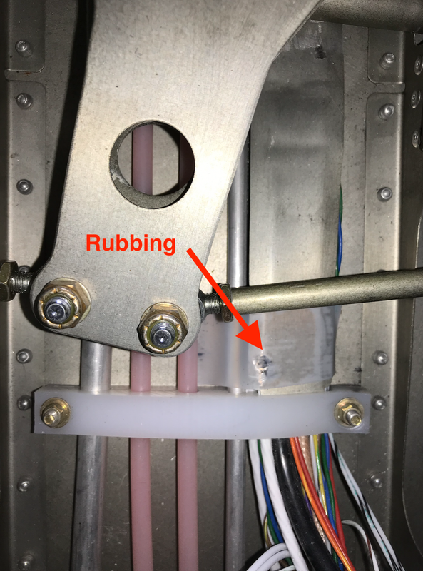

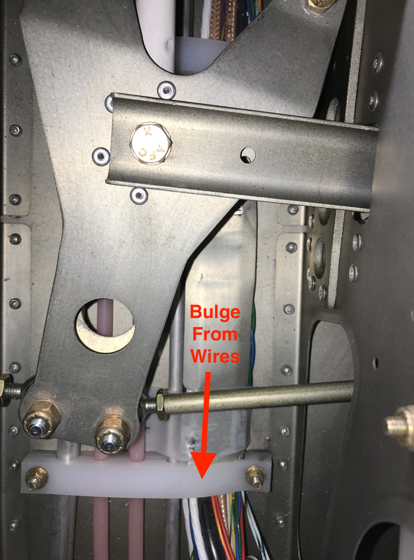

My friend?s RV-12 built by Synergy as an E-LSA has a rod-end bolt head rubbing on the wire bundle hold-down plate beneath it. We put Teflon tape on top of the plate and it didn?t solve the problem. The wire hold-down plate is raised up because of so many wires ? main wire harness, ADS-B antenna Coax, Comm Coax, AOA tubing, etc.
Anybody else seen this? Suggestions?
