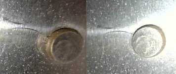

Annual time, so again inspecting the outboard HS hinge attach rivets for cracking of the spar:
I'm using a Teslong inspection camera, a nice little unit with both side and end views on the borescope wand. The spec page says image capture resolution is 1920 x 1080. Does a pretty good job, with one exception. When looking at shiny unprimed surfaces, it's difficult to decide if I'm looking at a crack or a scratch. Primered parts, no problem. Anodized surfaces, quite good. It's just the shiny stuff.
So how to improve crack identification? Tell me a trick please. Remember, we're looking insde a closed assembly.
Just for fun, the photos below are the same potential crack, taken one year apart. No visible change. Crack or scratch?
looks like a scratch to me. The examples of cracks that I have seen related to this tend to have ragged edges, propagate radially, and mostly in a straigh-ish line.
I don’t have any tricks Dan. I have the same issue on the HS spar. I was able to get die penetrant on this area however. Didn’t help much. Pretty sure it’s a scratch.
I just watch it and no growth, no change, no problem. Document with photos as you do.

I've struggled with the same problem. Perhaps turn off the camera's light and get a separate fiber optic light to come in from a different angle than the camera lens.
Puff some tire talc in there to kill the shine? Never tried it, just a thought.
I spent a decent part of my early career working with machine vision systems, and regularly work around people that still do. Lighting makes all the difference in some images. Try lighting from different angles, and vary the brightness. Off-axis lighting (fancy way of saying light the image from the side) can show amazing things. Some colors of light make some metals ‘pop’ more than others, though my memory isn’t good enough to tell you which colors work best for which metals, and if memory serves, I only remember witnessing that on black and white images, so add in a color camera and things may change. That said, I’m not sure how to accomplish that in the instance of this inspection since I’m still building and haven’t done the inspection myself, so some creativity may be in order. Judging by your history of posts, I’d say you have plenty.
To me what you have looks like a scratch. The metal grain seems to carry through it on one of the images.
Just running the pics through a number of light filters you can see the grains running perpendicular to the scratch as Sam says.
Doesn't appear to even break the surface.

I had mark like that, I think came from shoving my bore scope in there and the tip made the mark. I squirted a little WD40 on there and it disappeared. If it was a crack it could not have disappeared.
Dan,
I don't think the light would travel almost perpendicular across a crack as it does in your two photos. Across a scratch it is plausible. I say enjoy another year of flying your RV-8.

Both photos in post # 1 seem to show a direct reflection from the lighted scope. If the scope is positioned at an angle that's not perpendicular to the surface being inspected, the light will not be reflected back into the scope as much. Try this: in a darkened room, put your cell phone "flashlight" right over your nose and shine it at a mirror. You'll probably see not much but the flashlight in the mirror. Now move the flashlight off to the side, and you'll be able to see your face illuminatedby the flashlight. For the inspection in question, one view looking from a bit below, and another from a bit above might be prudent.
All the current photos are indeed lighted with the LEDs on the tip of the camera wand. I have the original tooling hole in the end rib and a second hole created just for this inspection. I will try the insertion of a standalone light and turn off the camera lighting. Will report.

Do a test scratch and crack on scrap and check it with similar lighting. The enlarged pictures appear to me to have the same grain as the adjoining material and to me that would be a mark or small scratch.
It's a tool mark, possibly from the original inspection camera dragging along the spar.

And now, the rest of the story....
Tip 'o the hat to those who suggested auxiliary lighting. Lots of LED options these days. Turns out there is a type called COB light strip, in this case USB powered. Easily slips through a 1/4" hole.

Stuck it to a narrow aluminum strip. Worked best when pointed away from the subject panel, so light was diffused.
Compare this with the grainy mess I posted previously...schazam!

Now that is a slick way to get rid of cracks. Need to market that. Oh, Wait there never was a crack to start with just an illusion. I do like the outcome though

Hi Dan, from my experience as a Quality engineer in the medical device industry (specifically endoscopes, laproscopes, arthro-scopes, if you can adjust light source intensity it helps greatly. Another method is a pale cellophane in pink or red will allow for viewing more detail without reducing light intensity. Incidentally it looks like a crack at the rivet hole
In the SB photos of the example cracks (plural) usually showed up in multiple rivets. If you just have this single rivet showing this possible crack it is probably a scratch. Continue to monitor.
