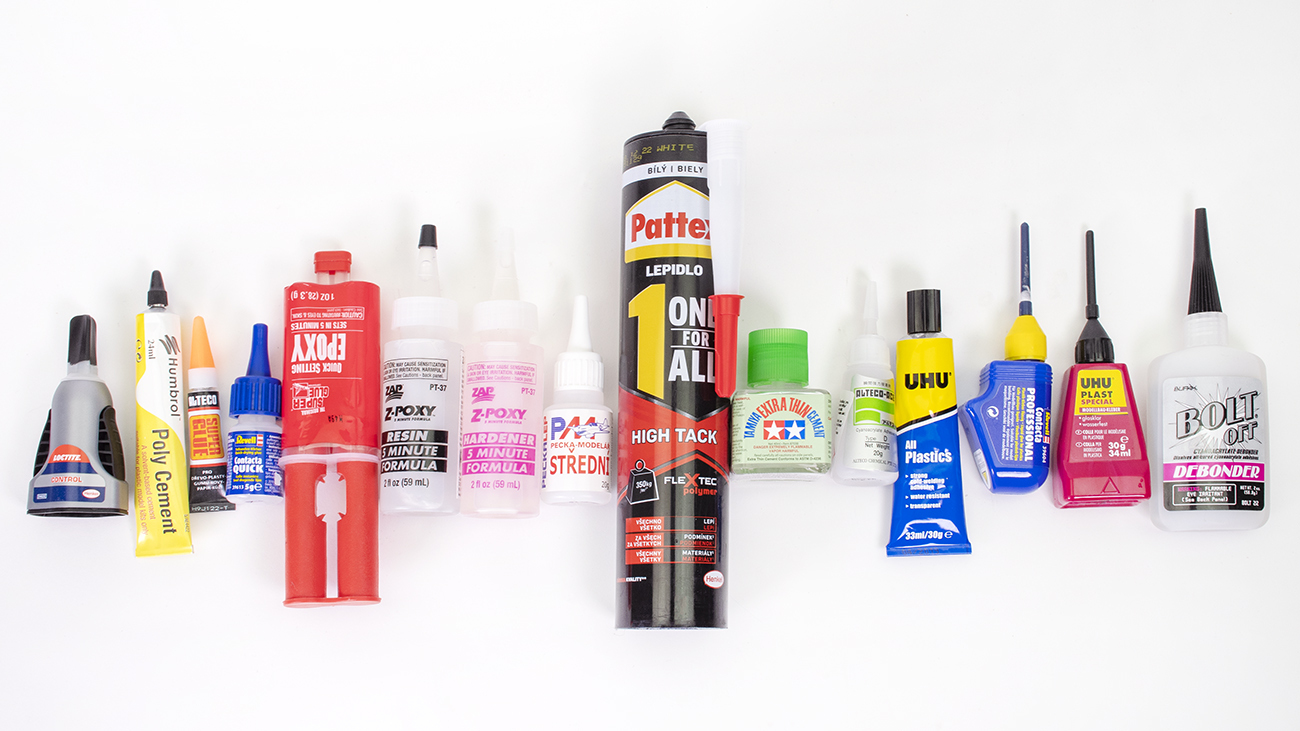

I managed to break a clip on my 3D printed headset control holder. It’s a clean break and fits together very well. Is there a best glue, solvent to weld, or heat to weld that is the strongest repair?
How do I repair it?
If it's printed in PLA, I've had good luck with medium viscosity CA (cyanoacrylate, super glue). Acetone can weld ABS parts together. Otherwise I'd try a soldering iron with a tip you don't care about, and some filament of the same material to weld it.
Not ever fooling with 3D printing, I can only describe the material as black plastic. Acetone didn’t phase it. I was thinking of our good friend JB Weld epoxy may be the best solution.
Most 3D printed parts are likely to be PLA, but you may occasionally see PETG or ABS. There are solvents specifically intended to glue PLA that you can buy. I've used PLA GLOOP before and it works great.
The go-to in the 3D printing world seems to be Gorilla Glue's version of crazy glue, although i've used LocTite's version as well with equal success. Both come out as a gel and it's not an "instant" bond but will bond up rock hard in a few minutes. Seems to work well on both PLA and PETG. If Acetone didn't phase it, I don't think it's ABS.
Here is an excellent guide to glues and solvents for 3D printed items. First step is finding out the material the print was made from. If your 3d print is suffering from poor layer adhesion during printing, you can expect additional failures. If the parts are large enough a hot wire welder might work with the glue.

I don’t remember where I purchased since it was two years ago. I don’t know who printed or what it is printed from. I will try a drop of Weld-On on the back to see if it melts it. If not, CA glue. If that doesn’t work, garbage bin and order another one.

Weld-on didn’t phase it. CA seemed like it was the ticket till I snapped the controller in and cracked the glue seam. It’s now in the trash and a new one on its way.

PETG is used more often in cockpits because it handles temperature better than PLA but more flexible than ABS, but it doesn't adhere with glue very well if at all. The best way for PETG is to melt it back together with a soldering iron as others have mentioned.
