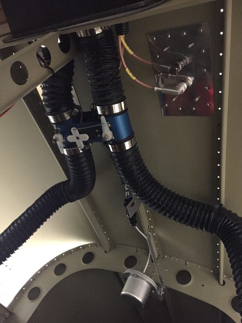

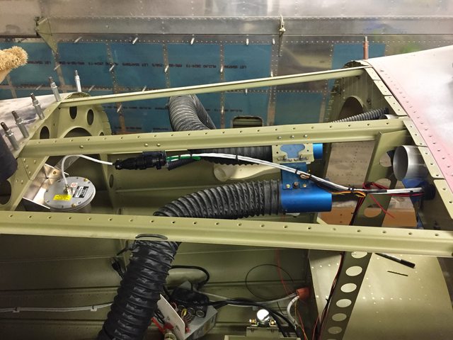

Would you have a picture of how you mounted it on the F-1008?
This is the only one I could find quickly that had the magnetometer in it. It's not a great shot but hopefully you get the idea.

It appears, from the pictures, that Todd mounted his on the second bulkhead aft of the baggage bulkhead (i.e. closer to the rear) and Jason mounted his on the first bulkhead aft of the baggage bulkhead. What does Stein recommend? are both bulkhead locations equally good?

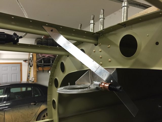

Here's mine. No problems, even with the Aerosport NACA servo mounted in front of it. This is using the mounting bracket that Stein sells.
Notice I also added a "kicker" bracket. It felt like it could wobble fore/aft a bit without the extra support. It's solid with the kicker.
