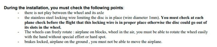

This is from the Beringer 5 and 6 in Maintenance manual.

Thanks all for the feedback...kind of mixed results. while the manual notes and in theory everyone wants our brakes not to be dragging, it seemed those that went and physically checked seemed to have the same results that I do, that there is residual drag or very slight clamping force left.
I dont have a parking brake, only 1 set of master cylinders, tried with and without the AILR, different reservoirs, new brake lines, calipers etc. Just seems the caliper pistons are fairly stiff in their design and sealing and dont "relax" much at all after pressure is relieved.
