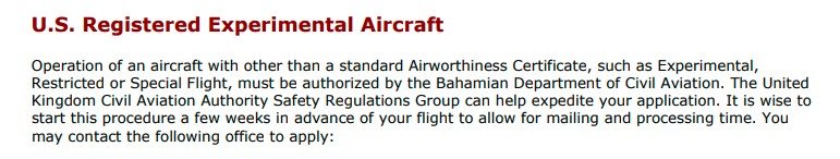

And then there's this requirement for Experimentals......??

Thanks everyone for the input. I'm assuming being an experimental not an issue?
No issue at all. Google Bahamas Civil Aviation Department...look for "A special airworthiness certificate-experimental, for the purpose of operating Canada or United States-Registered amateur-built aircraft in Bahamian airspace". I printed this and had with my document files just in case. No one asked to see anything except our Passports. I would still have all your ducks in a row, just in case.
