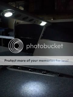

Yep....
LED's on a battery. The switch is a toggle on the crossbar support for the rear seat backs. The LED lights are mounted there too and shine into the baggage compartment.
If I leave it on accidentally, it's no big deal. But with LED's it should give you power from annual to annual, so just replace the battery during your condition inspection.

So local battery, not ships battery? Which LEDs did you use? I assume there has to be something that fit those lightening holes (ha - a purpose and a pun!)

I got lucky. I had some small LED lights I had sitting around I was initially going to use as wing inspection lights but they weren't bright enough. Turns out they are an EXACT fit for the lightening holes in baggage cross member area! Batch drill the screw holes, add a few nutplates and whammo! I added one on both sides and then added a simple switch on the cross member as well so I can open the baggage door and Turn it on and off as needed.
