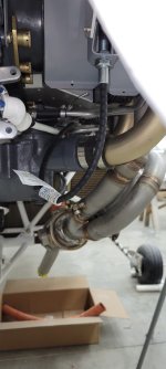

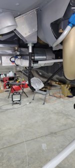

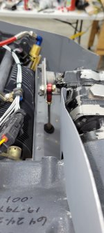

Here are some pics from the old original installation with the brick. To be clear, when I said reclocked, i meant fore and aft, not twisted... had to do it to clear the cylinder once it was lengthened.
Best of luck!
I'm using the stock bracket. When you said "Clocking" it got me to thinking of how to orient the bracket so the hole in the bracket would align with where the cable comes through. Rotating the bracket solved the problem. Shouldn't make any difference how it's oriented and doesn't require me to reduce the size of the bracket flanges to fit in the space available. Thanks for the pix. That's a very beefy bracket.....should provide plenty of support!
