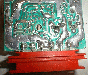

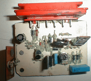

I received my firewall forward harness today. I completed all the conections. I turned on the master and smoke started coming out of the regulator/rectifier. I sure hope its a bad regulator. It was my worst nightmare to see that happen. Checked and double checked the wiring before hand. Everything seems right. I shut it down right away. I think a new regulator is going to cost about $170.00 . The only fuse that blew was the EFIS fuse. All other are ok.
I sure hope it didnt cause other problems.

We have found the Rotax 912 series regulator to be fairly flakey, although I haven't heard of one smoking. They can be replaced by a standard Ducati motorcycle part.

When you removed the connector from the regulator were there any burn marks on the pins of the regulator or the spades of the connector? Also, could one of the pins on the regulator have bent over into contact with another pin? I've noted it's really hard to seat this connector and it doesn't give much feedback that you are seated. I reported this via email to Vans on Friday.
