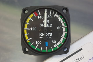

Looking for an Airspeedindicator as a back up.
Van's is not selling one with the correct markings for the RV12 yet.Any other source? Maybe it's an overkill,but I just want to be on the safe side....

Karl, I just added markings to my 2 1/4"ASI with vinyl stick-ons from Aircraft Spruce. Fiddly job with a hobby knife and tweezers, but it looks OK from normal viewing distance.

I had the same problem. Solved it with the help of Aircraft Spruce. I researched that I wanted to have a Winter ASI in 2-1/4" size with 510 degree range. That way I get a lot of resolution on approach without wasting panel real estate. Winter will put any markings on your custom built ASI for a small fee and a 4 week wait.
Spruce came through with by far the best offer for this custom built and I am currently waiting for it. It should be here in about 2 weeks.

These guys in the UK provided my Winter 2.25 inch ASI and painted the arcs on the display for me.
"ASIs with a single revolution are ?227.00 excl VAT; ?261.05 including VAT)
Colour marking to your spec would be ?10 plus VAT"

I added an ASI from UMA. If you supply them with the ranges, they will add the proper bands to unit. I think the added cost was only about $ 20
