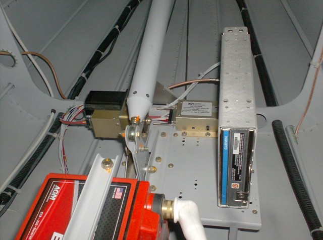

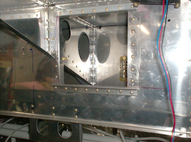

So my installation is nowhere near as elegant as Ed's, but my help someone anyway:
So here's the cutout in my sub-panel for my radio stack (audio panel, SL 30, and GTN 650). To the immediate right is where I mounted my G3X AHRS on two pieces of angle that run fore-aft between the sub-panel's lower flange and the lower instrument panel's lower flange. My VP-200 control unit is to the immediate left of the center brace (you can see the mounting nutplates).
Here's another pick showing the empty instrument panel in-place:
The only remote unit I have is my transponder which is mounted on Van's AHRS shelf behind the battery:

I made up foam blocks, from pink/blue foam, to the dimensions of the boxes, including connectors. (I glued foam connector blocks in place with 5 min epoxy where it was easier than cutting them out in place) Then with double stick tape I tried various arrangements thinking about future access for removal and connector positioning.
It took less than 2 hours to have everything settled. I then used the positions to measure for the wire harness using flat ribbon to mock up. Don't forget service loops!
