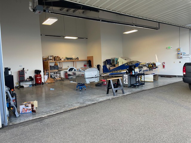

I'm building an -8 fuselage on a rotisserie. I've drilled the legs to the fuse, then stored them. Doing all the wiring and avionics on the rotisserie, no legs, no fwd top skin.
This pic is from when I moved to the new hanger. But, as far as landing gear and fwd top skin, it looks the same.
