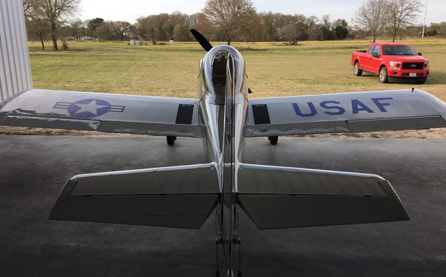

Brian Carroll's "Aurora". 10 year old auto paint and it still looks brand new.
Mine is painted with Chrysler car paint (base coat and a clear coat) and it looks shiny and bright since 2009 even in the shade. I agree the prep and painter make all the difference versus the cost of the paint.
