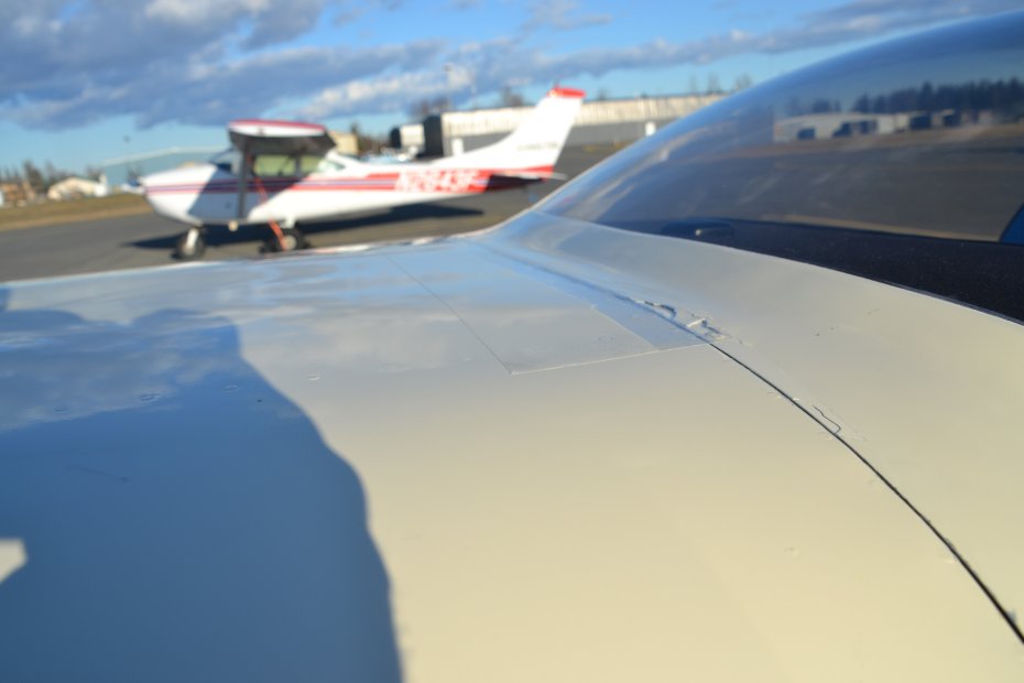

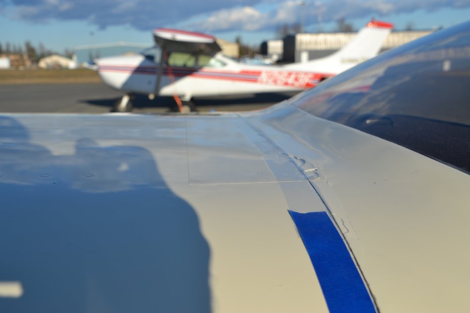

Step one was open the canopy and make a small mark where it opened directly above the cowling,
Step two found me using masking tape to tape the plastic wrap the length that the 4” tape was going to cover. Then about 6” extra length of plastic wrap would insure complete coverage when the 4” tape was applied.
Step three was when I took a xacto knife and cut the plastic along the seam where the canopy and cowling meet. Now the plastic wrap width was correct. Here is a photo that shows step 1, 2 and 3 completed:

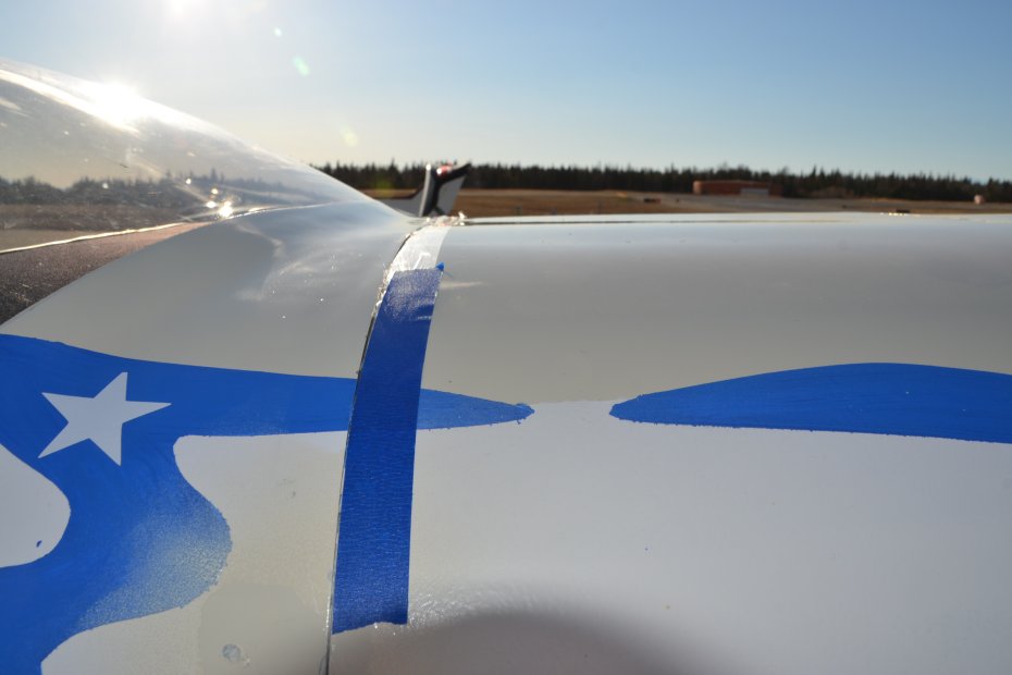

Step four dry positioning of the 4” 3M tape and cutting to the correct length. Basically centered on the top part of cowling along the flat portions, not on the curved sides.
Step five lined up the 3M tape, peeled the backing from the sticky side and stuck the 3M tape down along the path across the very top of the cowling, using at least 1” on the canopy and three inches on the cowling. Pressing firmly to insure a good bond along the length. You can see when it is bonded correctly, it almost can’t be seen. Here are two photos showing the 3M tape applied and the plastic wrap strip can be seen under the 4" wide tape:

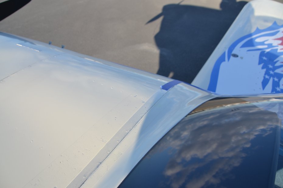

Step six was to trim the plastic wrap to the ends of the 3M tape. Remove masking tape and excess plastic wrap to a dumpster. Photo showing 3M 4" wide tape without the masking tape and the plastic wrap is trimmed to the end of the 3M tape:

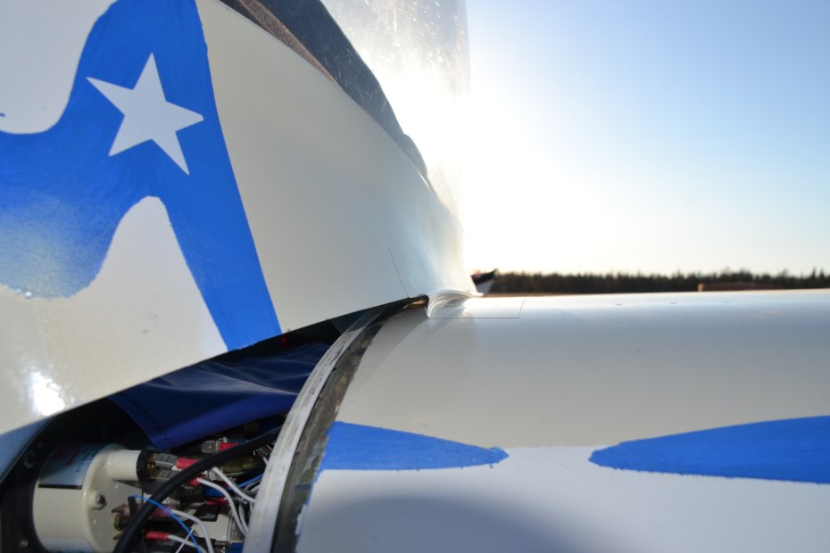

Step seven was when the canopy was opened to see if it worked. Notice the fold when the canopy is open:
My canopy opened in flight a year or so ago, it bent the aluminum frame up in some places-you can see the damage under the 3M tape in the photos.
