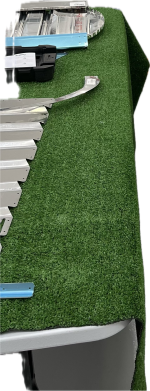

I’m getting my shop set up for my upcoming build. What is the best surface for my assembly table? In the wood working world, a table with a Formica top is common. Wood slides over it without marring, glue doesn’t stick to it and it looks nice. How well would that work for aircraft building? Is there a better choice?
I use mdf. You will want to drill into whatever you use, so don’t make it furniture! For skin assembly and such I use a piece of the cheap astoturf. Not carpet. The chips fall through it so you’re not grinding them into the skin.
Personal preference. Every builder finds what works for them. MDF, formica, carpet, etc. I do like the astro turf idea though. Clever.
