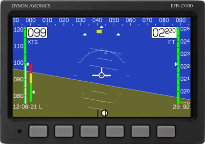

Here is a pic of what your HSI should look something like if you have the GPS communicating correctly and you have a waypoint active in a flight plan on the GPS...
If your HSI does not work correctly, neither will the AP.

That photo is overwhelming to a person not used to viewing the D180. I am not sure I can ever figure out what all those symbols and readings are for.
Don,
It will come to you...You can turn stuff on and off to your liking...That pic pretty much shows everything + the HSI.
Here is an example of how minimalistic you can make it:
You can even take it further and remove stuff like the AOA bar..
Note that this shows the "Classic" display mode, you can switch between classic and modern....
