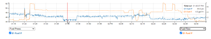

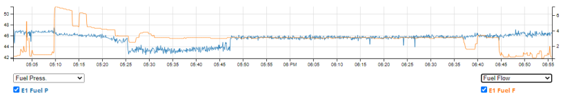

Amazing coincidence. Yesterday I had the same experience with my fuel pump quiting (after 11 minutes). Switch light went off, and pressure dropped to 44.2. No signs of this happening in earlier flights. Great video.
AM-JKLWmmKJycY2jSYgP9dg3qzwhaROa8l4VA7KdWF7Sl9LPoXgBSrUoRrjqTHGRSK-2pqTED0t6kdELSG-dcSafrmp1i3XzMX64mYZNg9MpMffrL6LRKwK3-1c_2hkmVtWjxowvbqPNBIOD2MuWnbTnpOAj=w500-no
I'm unsure if I posted snapshots of my Fuel PSI vs Fuel Flow in this or other forums, but that's about what I saw. I'll post a couple below. Its normal to see a slight drop in pressure as flow goes up.. maybe about 0.5psi from idle to full-power
Unless I happened to look down and see the light out, or notice < ~45psi, there is no way to tell - no alerts, engine sound change, etc.
Now that I'm all fixed up with Van's draft Service Bulletin, I may experiment with changing the Fuel PSI warning (yellow) level in the G3X. I'm careful to document any settings change in my Avionics Logbook when I deviate from Van's standard configs.. and I suspect the exact cut-off number will vary slightly from aircraft to aircraft..or pump assembly to pump assembly.
