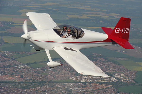

What a nice aeroplane the 12 is - what it needs is a great color scheme like your one I used on our RV7.

Randy stole the best scheme going....
I copied it on our 7
Simple, warm white, accents, grays, reds etc
