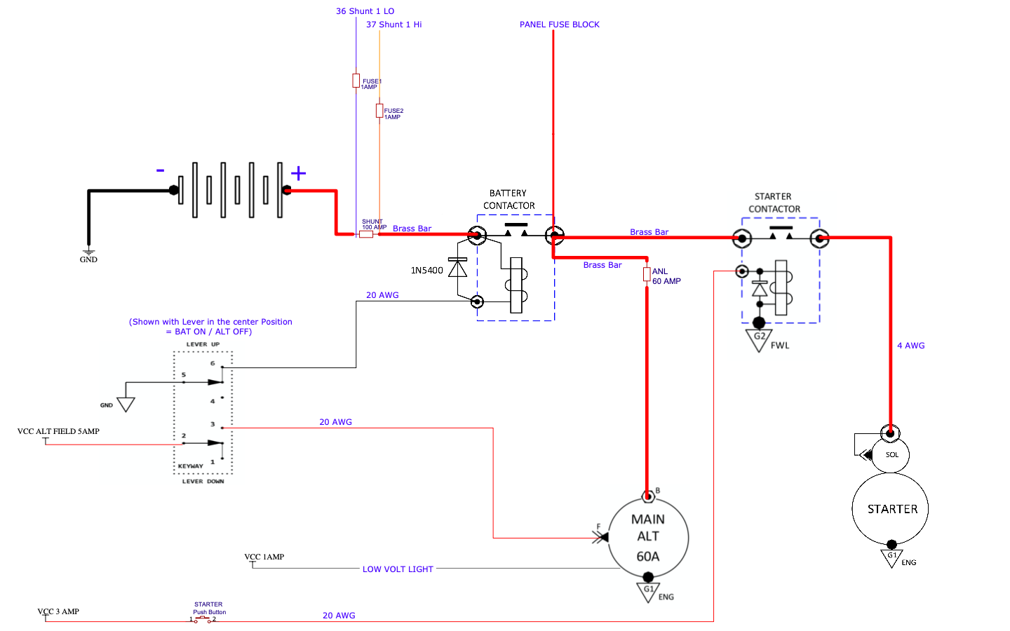

Hey there. I have looked at old post and read a bunch about the FWF big wires and stuff. Where to put the shunt and what not...
I understand people have opinions on weather or not to use an ANL fuse. But the ones who doe use one on the B lead that is actually a bit larger than the max rated output of the Alternator.... at least I read that a few time.

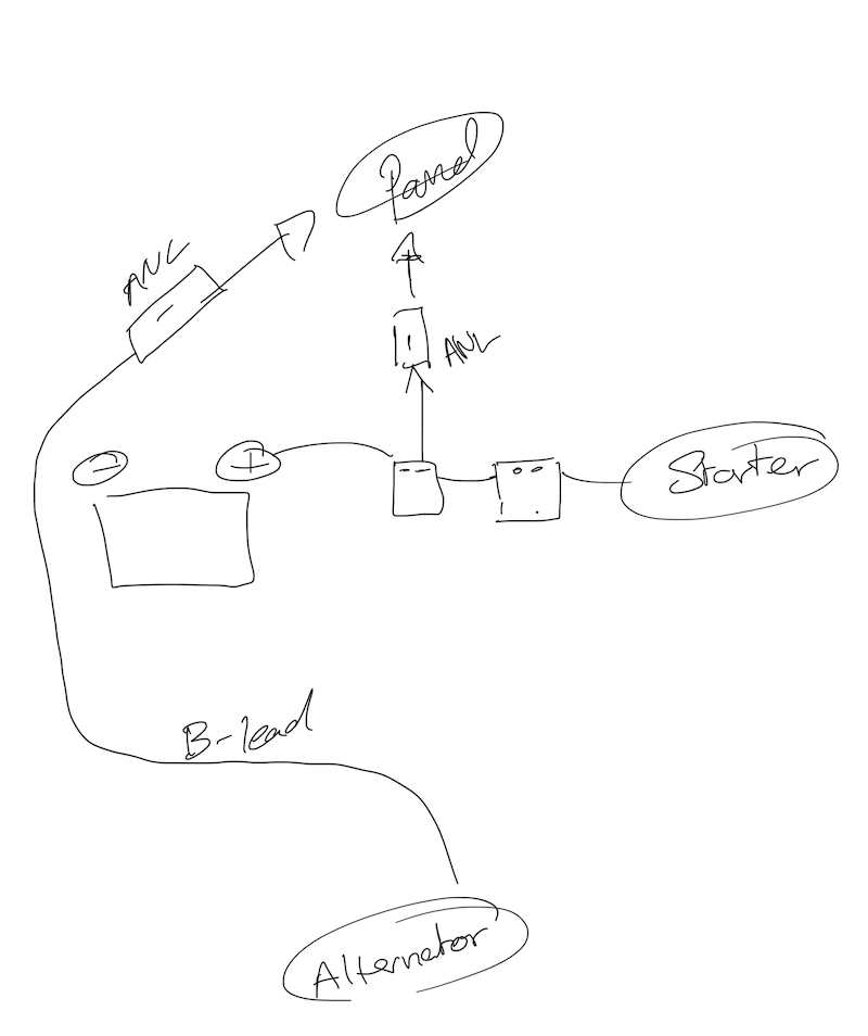

lets say its a 60AMP PlanePower Alt. on the RV14 the B lead seems to go straigh to the panel and the wire from the from the batt contactor also meets it there...
If I put them in line together with one ANL that means if the ALT produces to much energy the battery will also be disconnected when the fuse blows...

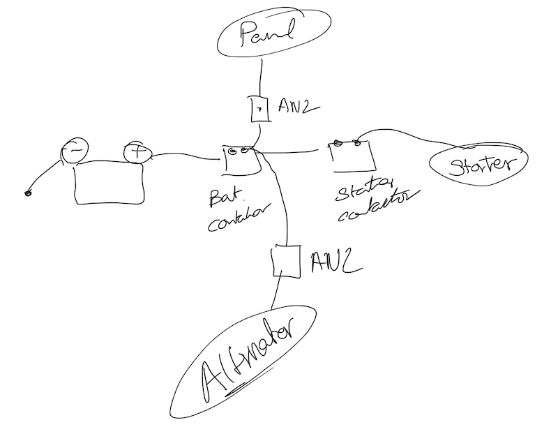

If I put them in parallel and one ANL on each I would have to put a bigger one on the battery than on the ALT or they will likely both blow at the same time??
download
What do you think? I understand that I am asking for opinions here.
My thinking is that an ANL should protect the B lead , so mounted before the shunt and any other connection to the buss or battery.
If you remote mount the battery in the back, you could mount another ANL near it to protect the long Pos Battery lead.
If you mount the battery on the firewall & have the mast solenoid close by, it’s debatable if you really need an ANL between them, I wouldn’t bother.
Placing an ANL between the mast solenoid and buss offers no protection to the circuit if a problem happens anywhere up stream of that fuse.
The job of the ANL fuses is to protect the cables leading up to the buss, not the buss it’s self. If you wish to protect the buss from over voltage events, there are various devices you can get for that protection.
Thanks for your input Ralph.
I guess my train of though was that this way in the event of a short there would not be a hot cable going past the firewall. Also I realized I had the picasso drawing missing the ANL on the B lead on the one drawing.... I added that.
Shunt in that location will show battery state only, how many amps it is accepting when re-charging, or how many amps it is discharging if alternator is off or off line. Most of the time after the battery is recharged, it will likely show nothing, or close to ‘0’.
If you put it between the 70a ANL fuse and battery contractor, it will show the alternator output, more dynamic indication & shows your normal operating load - this is the more common shunt installation location, better for monitoring your charging system health.
You could also put the shunt between the battery contractor & buss but would only show your operating load & not give you any indication of the health of your alternator or battery

I have been going back and forth on this. I read the Wiring guide by mark ausmann and it claims that the alternator health can easily determined by the Volt data. 12,x means not working 14,x working. Or is there more to it?
What else am I seeing by putting it on the p lead? it will tell me the output of the alternator (what my bus is using + what the battery is taking. No way of knowing when the battery is full)
at the battery I will see the health / charging level of my battery. This I would otherwise not know. correct?
I guess I am not entirely shure what I "need" my last Cessna had it on the battery...Doesn't mean it's the way it should be.
I guess I could do both.

Alright they will be since I will have it all right next each other on the Firewall.
So if I were to do it like this. do both take a 70AMP ANL? wouldnt they both blow at the same time? in that case the panel goes dark. Would it make sense to put 70AMP on the B lead and something higher 80, 90 or 100 on the in front of the bus? This way the alt is off but the battery keeps working and the panel stays on until its out of juice...
For some reason I am always assuming that the alternator has the potential to supply to much amps. is there a battery failure mode that will do it as well?
No, the alternator cannot supply too much amps. It can supply up to it’s rated output and then a bit more sometimes. It can supply too much voltage but that is addressed another way. The thing to remember is that circuit protection (fuses, circuit breakers, etc) are there to protect a wire from burning should there be a short somewhere downstream of its location. In the case of the alternator ANL, it’s job is to protect the wire between the alternator and the battery should the alternator fail causing a short to ground. It would be out of control current flowing TO the alternator, not FROM the alternator that would burn the wire. The alternator wire itself should be sized to handle the full output of the alternator. This is why the ANL fuse is to be located near the battery.

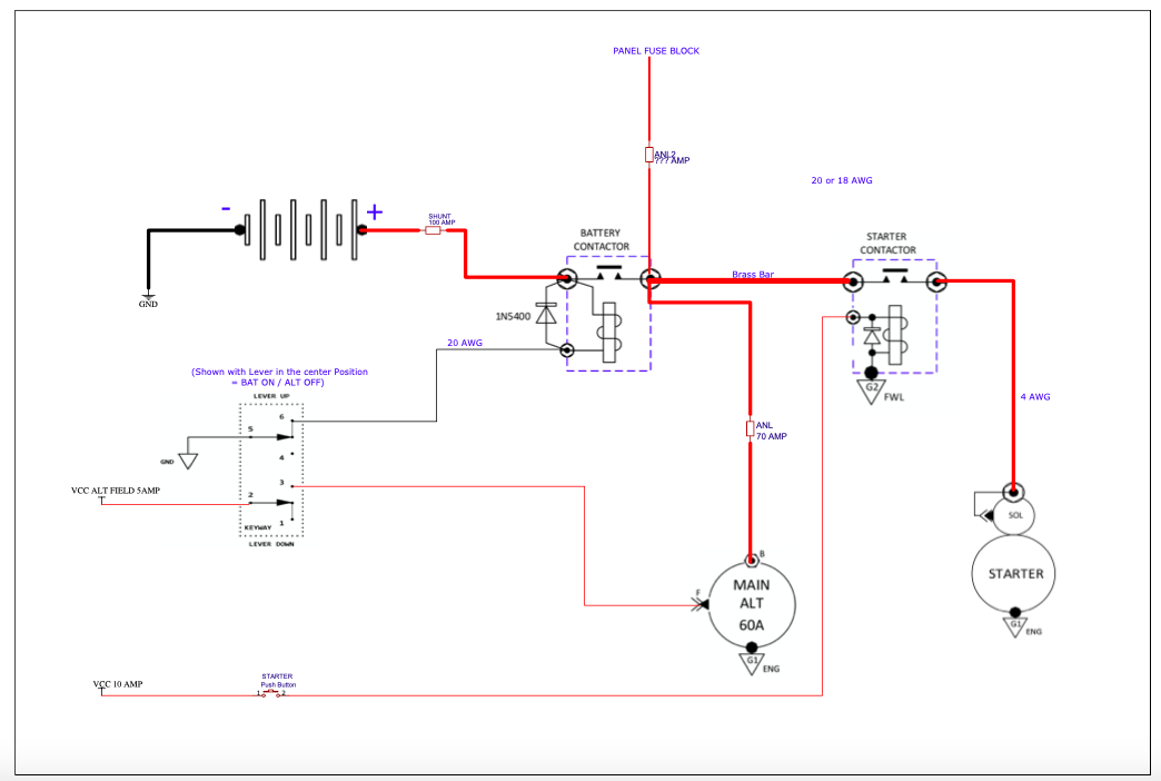

I think since this panel has only a backup battery on the G5 it would be wise to install it in a manner that a short does not take out all the lights.
70AMP ANL on the Alternator before the shunt.
Or I can tinker about a backup battery... haha

What I ended up doing for anyone who may read this later...
Alright guys. thanks for all the help. I wanted to take a minute and tell you what I ended up doing and why. The thread took a bit of a drift that was not my intention. For some reason some people kept taking about an ANL on the Starter wire. THAT WAS NEVER my intention and makes very little sense.
Anyway This is what I did on the RV14.
Please note that based on Dan's suggestion to keep the ANL and Shunt close to the contactors, I actually used brass bars, so they are directly connected to them.
I decided the ANL fuse on the B lead of the Alternator. Should that short out. The rest of the ship will be isolated and still run on the battery.
I decided against another ANL fuse between the Bus bar and the battery contactor.
I decided to use a Battery Shunt instead of the Alternator Shunt.
I know most people put them on them on the Alternator but I now get a negative reading showing in AMPS that will let me know how fast my battery is being discharged. Since I set the G3X to alarm anything under 0 it will show a red BATTERY AMPS if the alternator no longer supplies power to the battery. I also have a separate warning light for the alternator. If the alternator is off I will see how many amps I am actually using from the battery and can use this information to shed the load by pulling CB's.
While the battery is charging I will get a positive reading.
I will also see a 0 AMP reading when my battery is fully charged so I know that my battery is happy and healthy.
Of course YMMV but this what experimental aviation is all about.
i did almost the same thing except my main bus ANL is right before it goes in the cockpit. So my starter current does not go thru the battery Shunt. All this stuff on the firewall is close together, so there are no long runs of unfused Bus wire. And all the wires that go into the cockpit are fused to prevent the possibility of smoke in the cockpit from an unfused power wire short. here is my schematic and a picture of the firewall. I havent finished with the sealer/firestuff, so it is not ready for flight.
i did almost the same thing except my main bus ANL is right before it goes in the cockpit. So my starter current does not go thru the battery ANL.
Actually that's a great Idea. You think the Garmin Shunt will burn out with the starter? Man I thought I had this done.... thanks for sharing.
I think it would be better to fabricate a fusible link rather than an ANL as the likelihood of finding an ANL fuse on a X/C trip would be slim to none unless you are carrying a spare.
Bob. The starter will not pull through the ANL but through the Shunt.
ANL on the B lead
Shunt on the battery lead
