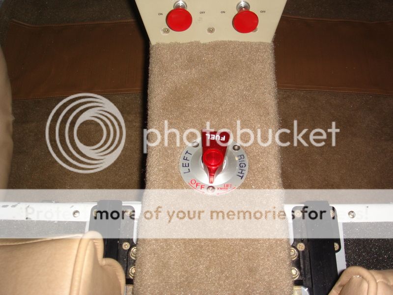

I put mine on the tunnel cover. I first machined a custom extension that protruded through the cover, drilled a clearance hole for it. Drilled out the Andair plate and made a custom delrin bushing for it that fit the plate tight and had a few thousandths clearance for the extension. Transferred the mounting hole locations for the Andair plate on the tunnel cover and installed 6-32 nut plates. Worked great and looked good also.

I found a photo of my valve location. I mounted the valve body itself in the per plans location, hence the custom extension. I also modified the Andair cover plate itself.
