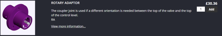

You could also "fix" it by using this rotary adapter, I did not have to:

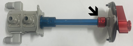

WARNING! A dangerous cross-flow can occur with an Andair EFS2020-D2-M Duplex Fuel Selector when using an extension between the valve body and the controlling fascia plate and pointer knob.
The red or blue drive adapters (shown in a previous post) orient the red pointer knob differently to the valve body. The fascia plate, with indents controlling the red pointer knob, can be mounted in any orientation. If the fascia plate is mounted 45 degrees off from its intended position, fuel may cross-flow to and from both tanks, and when the fuel level gets low, the engine may sputter, as if running out of fuel. You can imagine how I figured this out.
I suggest that you assemble the valve and its controlling components before installing it in the aircraft. Remove any 90 degree AN fittings to observe the valve flow orientation. Both the valve and the fascia plate have sensory indents that indicate when the valve is in the proper position, and it is important to mount the fascia plate according to the valve's proper function.
The red or blue drive adapters require the fascia plate to be mounted 45 degrees differently.
The blue drive adapter requires "RIGHT" to be oriented directly forward at a 12 o'clock position.
I received a red drive adapter (arrow pointing to it) and needed to mount the fascia plate with “RIGHT” oriented 45 degrees to the right.

View attachment 115724 View attachment 115725
personally, I think is a really good idea to mock up things like this, especially where safety of flight comes into play. Check not only for normal flow, cross flow, but also IF fuel is cut off when the handle is pointed in the direction you want. NOT a good thing.

Here's a drawing showing the potential for misaligning the facia, resulting in a dangerous cross-feed.AndairCrossFeed-01.png

That’s why this is dangerous, the engine will run with the cross flow. I had unknowingly mounted the valve facia plate in the cross flow orientation and tested to find good pressure and plentiful flow volume before the first flight. I flew several flights before noticing fuel coming out of both tanks. I purposely flew with only the valve at 12 o’clock pointing the Facia plate “RIGHT,” then measured the fuel in the tank with a glass tube. Always finding it the same in both tanks. I then disconnected the return line at each tank and ran fuel into cups and found the right tank return anemic and the left plentiful. After contacting Andair with a few emails and three phone calls with no responses, I inquired other knowledgeable builders. They confirmed something was amiss but no clue as to what. Toren from Andair eventually replied via email, retitled the subject as “Cross Flow,” but didn’t offer any suggestions as to what might be the problem. I then pulled the valve out, akin to open heart surgery, to reassemble on the bench and found the misaligned valve holes, at this point realizing I needed rotate the Facia Plate to align with the aligned valve holes. Explaining this to Toren, he emailed that I have the red drive adapter which requires rotating the Facia Plate. Up to this point I was unaware of a drive adapter. There no mention of it on my order form or list of items sent to me. I found no instructions from Andair and still find no mention of drive adapters on the Andair website.
In retrospect the cross flow explains why on a flight to get fuel, I had 10 gallons in the tanks and the engine started sputtering with low power. Fortunately, I was descending on the 45 to the airport and performed a somewhat power off landing, then sputtered to the fuel pump. After filling the tanks, the sputtering went away and I flew home to diagnose and fix the problem.
