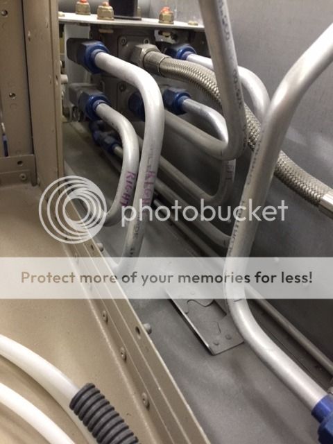

I am working on my tunnel and associated fuel lines/selector. I will be placing an Andair FS2020 fuel selector (duplex). Ordering direct from Andair.
Can anyone help me with what would be the easiest fittings to place? Numerous options for both the upper and lower ports, and it is difficult to visualize all those fuel lines at this point.
And how long on the extension, and do I need any universal joints? I will be using an Aerosport center console and panel.

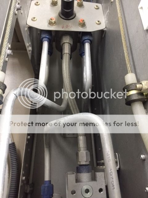

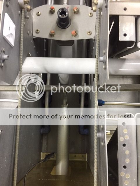

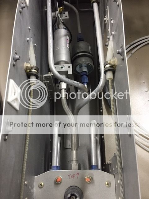

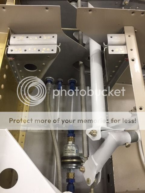

Hey, I will try and get some better pictures to post for you today. It was a real pain to fit all those lines in and if I did it again, I would consider flexible lines...
I will try and post shortly...

Rocketman, those pictures are priceless! Thanks for the great help, this will enable me to order the selector correctly outfitted.

We've done various forms of this install in RV10's. The is room to use straight -6 AN adapters from Andair on the supply and return sides, with 90* hose ends.
All of this will take alittle planning, buts its not as bad as it looks.

nice thing about the 10----there is room to play with unlike the 7/9. Yep, straight adapters out of the valve, 90* hose ends going aft to the supply and return ports. The front ports have plenty of room to run the hoses/tubing for the pump and returns.

I agree with Tom. If I did it again, I would use the flex lines with 90 degree ends. Hopefully, these hard lines will work just fine but if they do leak, I will be calling Tom for the flex lines...
