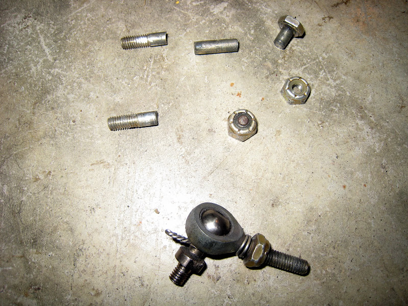

It was a very short flight over to our neighboring airport this evening to attend our monthly “Choir Practice” (no actual singing takes place – it is simply a hangar get-together….), and as luck would have it, someone had parked a truck where I usually put the airplane. In order to give myself an “out” when I wanted to leave, I swung the Val around hard – but misjudged the edge of the pavement just a wee bit….
The sound was sort of a “Bang/Snap/Crunch!” Whatever …. it was loud, and I could tell I wasn’t going anywhere. I shut down and climbed out to see that I had apparently invented the RV retractable tail wheel – the wheel was pointing up at the bottom of the rudder, having spun on the round spring, and there was a fair amount of mud spread around. Both of the cross-bolts that hold the tail wheel “knuckle” to the spring had obviously sheared. I was surprised to see a small muddy hole with no obvious fixed objects – I expected that I had unluckily hit something hard and/or solid, but this was not the case.
Truth be told, I generally change these bolts every other annual since they almost always develop a little bit of play, and when removed, show obvious signs of wear. I didn’t change them this most recent annual, but will now make it a yearly event – they are pretty cheap! Still, better for those to shear than to damage the spring attachment to the fuselage – we did a thorough inspection, and found nothing bent or popped after tonight’s incident.
Fortunately for me, I was broken down next to several hangars full of homebuilding tools and parts – we had it all back together before the party really got going. I had to get a quick ride home to pick up a spare tail wheel link we have on the shelf – the one on the plane was slightly bent and had a broken rod end bearing (repairable) – and everything was back together with about 20 minutes of work.
Memories of that awful sound will probably make me a little less casual about imparting side loads on the tail wheel, and I’m going to makes rue to swap the bolts out annually. Meanwhile, I have some little bits of “bolt shrapnel” to add to my “worn out parts” collection that I keep to remind myself that nothing lasts forever….
So - does anyone know the part number for that rod end? Double male AN3 threads....

Having those bolts shear is a common problem with RVs that get used a lot. It is very difficult (I say impossible) to drill these holes in such a way as to get a tight fit that won't wallow out over time.
Of course the fix is to install taper pins in these holes after first tapering the hole with a #2 taper pin reamer. Fix it and you can forget it. While you're at it, install one of Vince Fraizer's improved steel tailwheel assemblies to improve your over-nose visibility and to correct the geometry of the Van's assembly.
You might want to consider this. Glad there was no other damage to your bird.

I'm thinking about going back and looking at the taper pins - I have just never taken the energy to research it before, but after shearing the bolts, it might rise to a higer level of awareness!
And I haven't used a Van's tailwheel in years - I am a firm beleiver that the Van's tailwheel is "damage waiting to happen" due to low clearance if you drop it over a lip. The Val has an API (extremely rugged), Louise's -6 has a Bell, and we have one of Alex's "Bell Clones" for the -3. I haven't used Vince's casue I don't (yet) have another plane that needs one.... ;) This little incident, however, could happen with any of them - it is due to side loads and twisting around the spring.

I was thinking about the taper pin mod. However, I think it might be a good thing to have the AN3 bolts break under the excess side load. It's possible that the damage would be realized somewhere more significant if it didn't fail where it did (I.E internal bulkhead)
Anyway, it's got me thinking about upgrading my Van's tailwheel.
I went with close tolerance bolts...
.... and pressed them in. That took the slop out. I do expect them to wear over time as well, but so far, 100 plus hours, no slop yet.
My only concern now is that if they do break, I will have to press them back out! Not sure if being in tight will reduce th possibility of breaking or not.

I replaced the AN3 bolts with what we farmers call "split pins". These hardened pins are used to hold something like a gear on a shaft. You purchase a 3/16" split pin and hammer/tap it into place and then cut off the excess with a cut off wheel. I added a bit of lock tite while I was at it. In over 400 hours and four and a half years of flight the unit has remained lock solid. An added benefit is that there is no bolt head or nut showing and it makes a nice clean installation. These parts can be purchased at a local farm dealership for pennies.
Hey Tom, we call these "roll pins" here in the south. That is an excellent choice for an oversized hole like one would have in this case because they are driven in and will take up slop. Since they are tubular, one could drive a smaller one down the center of the larger one for additional strength.
Bummer! One of those good learning experiences. Rod end bearing your looking for is here. Part number depends on left or right hand threads.

Thanks - a little research showed it to be a CM-3S. Ive got to get a couple to rebuild the tail wheel link that will go on the -3.....
I really like the idea of the taper pins to tighten up the fit on the tail wheel-to-spring fit, but I want to make sure they aren't too strong. As some have mentioned, having those bolts shear is probably not a bad thing - much better than ripping the spring mount out of the fuselage. So the goal is a tighter fit with the same shear capability. I'll investigate.... thanks for the offer on teh reamer Randy - I'll let you know!
