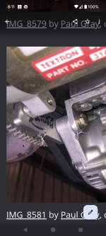

From my research on this forum I've found that the cross brace between the alternator and the starter is there to prevent the alternator from "bowing" which can lead to loosening of the alternator bracket bolts and potential failure of the bracket lugs. Duh! Apparently the B&C alternators do not require this cross brace as they are "precision balanced." I do not have a B&C alternator, so when I obtain a new bracket I will install a cross brace to prevent future failures.
