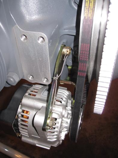

I have a plane power alternator from the FF kit and an IO540 ordered through Van's. The belt came with the alternator is too long (36 1/4") and the instruction says to order Gates XL7300 (30 5/8"). When I tried the shorter belt it is just too short (with the alternator pushed against the engine case I still can not get the belt over the alternator pulley). It seems a 34" belt will fit better. I just wonder whether any of you have the same issue. By the way, my ring gear has two grooves. The outer diameter of the grooves is a little more than 8".
I had the same thing except I don't have the air conditioning pulley. Will it go on if you roll it on? It may be loose enough once it's in the grooves.
I should be able to tell you later this weekend. I hope to mount the alternator on Saturday or Sunday.

I had a Gates 7365 belt with the standard single groove ring gear assembly and a B&C 60 amp alternator.
There are at least 3 different diameters of ring gear setups each of which will necessitate a different belt size.

Well, I did some measurements today. The ring gear assembly is LW12227. It has two grooves. When pushed alternator all the way in the belt length is 32 3/4". When leave the alternator at the center of the adjustment range the length is 33 1/4". It seems GATES XL 7328 (33 3/8") will work. Unfortunately, I live in an area that does not even have a Napa store. I tried AutoZoon and Advanced Auto, neither of them have the belt. I will have to mail order one.

Napa are Gates private label. Your local parts store, not the chains, carry Green Striped Gates belts

I just went through this. The recommended belt was a 15355 which was too short for my application. A knowledeable guy at work informed me that the last 3 digits are the length in inches. So my 15355 was 35.5 inches long. I went and got a 15360 (36 inches long ) and it fit perfectly. You might try your local autozone for a belt that will work..
Belt numbers
you are correct with the 15 series numbers which are Dayco numbers. Gates numbers this isn't always the case. If you will google Rock Auto Parts you can look up the number you want and it will show you the size and they will ship to your home quickly. A gates 7355 is 36 1/8 inch. Ask me how I know. 47+ years in the auto parts business.

By the way, last Thursday I sent the ring gear assembly part number ( LW 12227), pulley diameter (8 3/4"), and a picture to Plane Power. Billy at Plane Power is looking into this. I bet Bob will find the correct belt before Plane Power does (to be fair, they don't have the new ring gear). I will order mine online as soon as Bob has verified the correct one.
