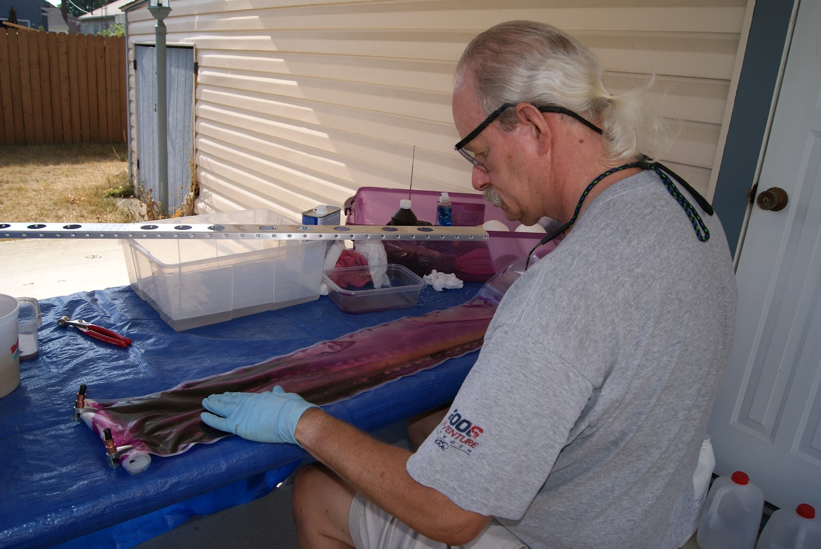

Can?t answer your question about the size of RV-10 parts but have a tip for processing long components you may find helpful. Did not use Alodine but a similar SanChem process on the RV-12?s long stabilator spar box components.
I elected to use 8" Seal-A-Meal bags. The bags come as a durable long hollow tube ? I unrolled more than enough from the roll without cutting and then clamped the plastic roll at the roll end to make somewhat of a seal. Slid the long part in, added the conversion solution, sealed the open end and sloshed away. This worked rather well but you do need to slosh the liquid from end to end otherwise the bag material will pull up against the metal.

Enjoy your build!
John
