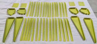

Yes, I primed everything, inside and out, and used two and a half two-gallon kits.
I'm certainly a below-average spray painter, with plenty of overspray and waste, but I didn't apply it too thickly. See examples.
I was worried about corrosion of components sitting in the workshop (a farm shed, in a warm, humid climate and dusty environment, surrounded on three sides by salt water and less than a km from Australia's largest coastal salt lake). Although I stored the as-received parts in what seemed to be clean, well-ventilated racking, I still found plenty of minor corrosion after a year or so when I came to un-rack components for construction. After priming with AzkoNobel 10P4-3NF the problem went away.
