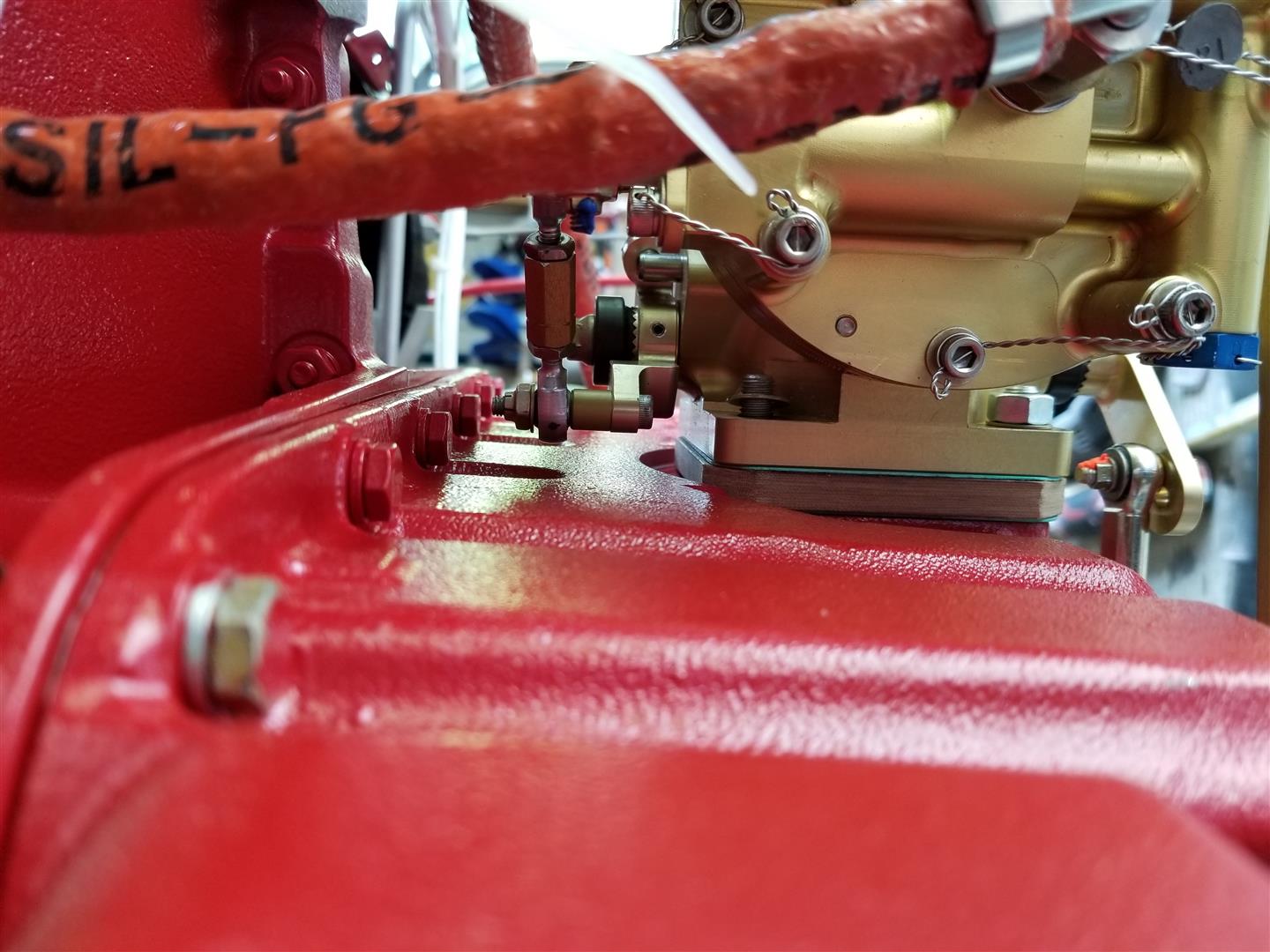

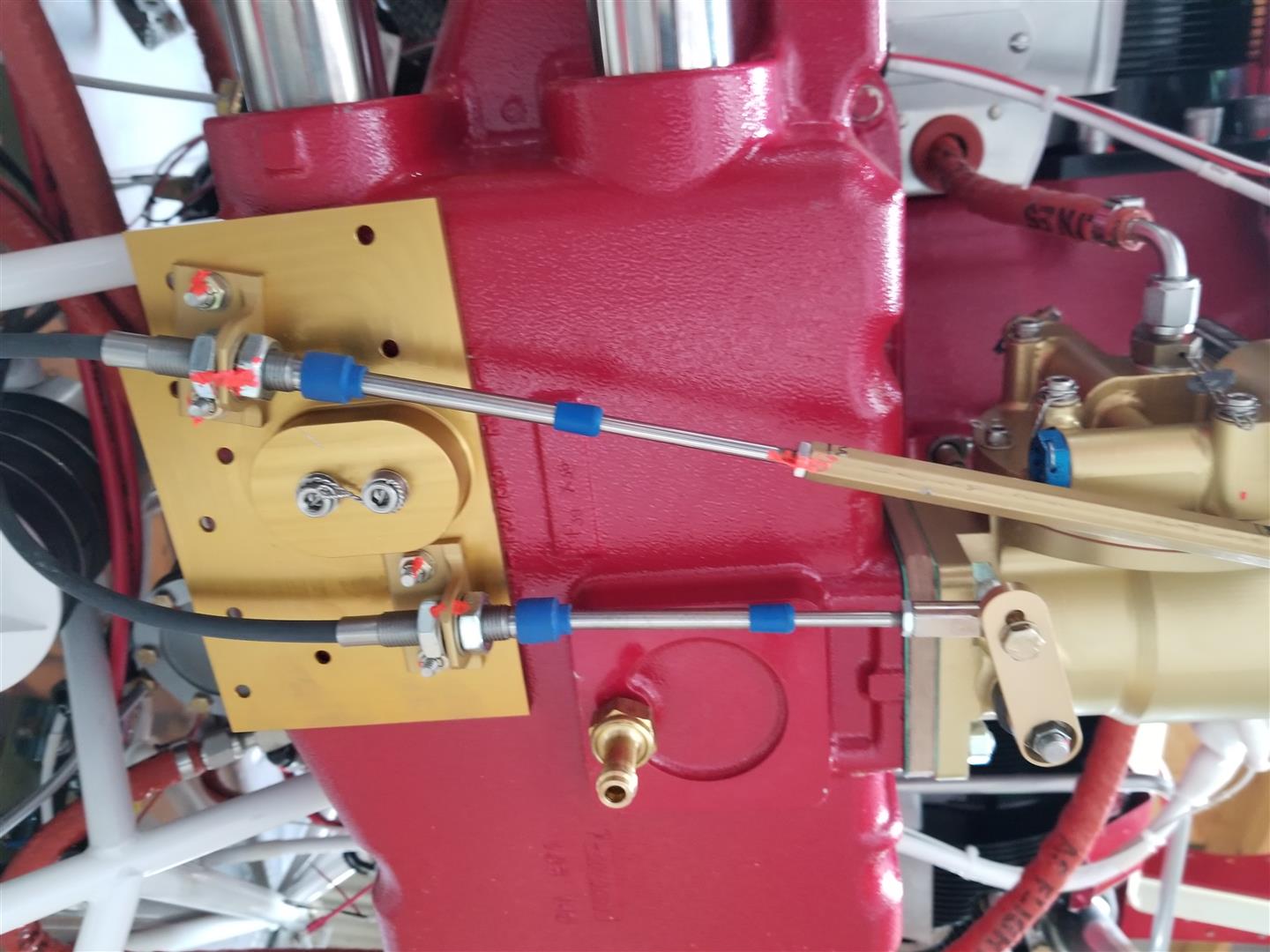

I installed the kit from AFP this morning and all went well and fits correctly. Easily done in a couple of hours.
Sharp eyes will see I only have temporary nuts holding on the FM-150. I will install the locknuts after I confirm all looks good with my tech counselor.

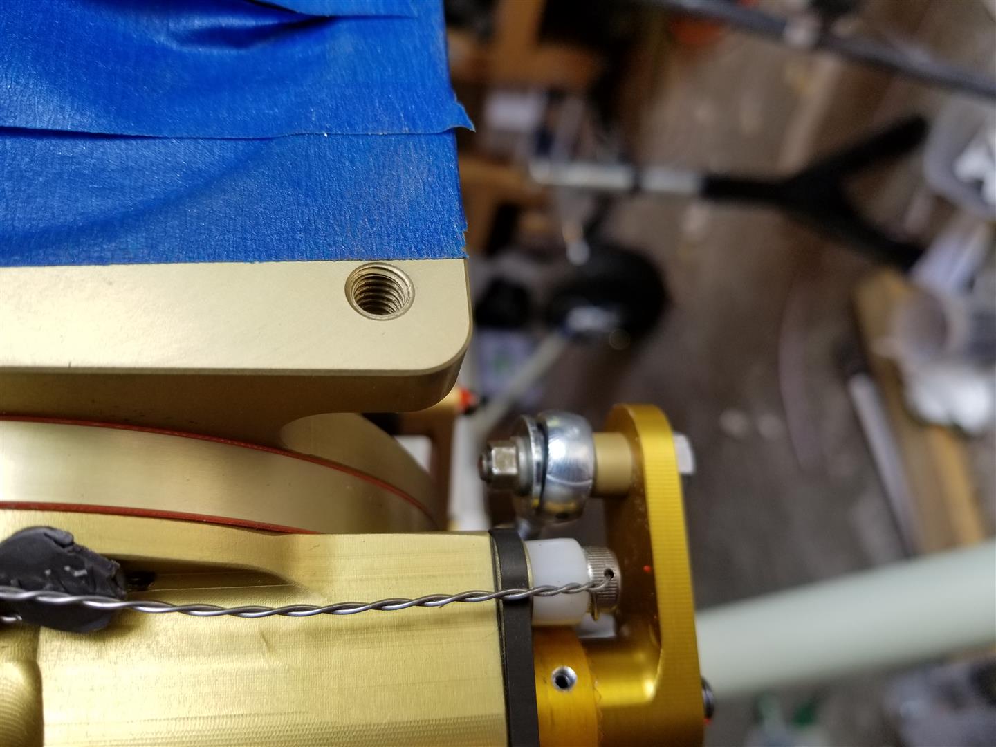

The spacer between the sump and the servo, in the picture, appears to be balsa sandwiched between two thin sheets of aluminum (Mallite)? If this is true, I would think the lack of compressive strength would be an issue.
What is the purpose of the spacer?
If it is required, than it appears that the hex rod for the mixture is too short. It looks like the rod end only has 2-3 threads engaging in the hex rod.
And I agree with Dan... put some safety washers on the rod end bolts.
...and put some 970's on those carefully gooped rod ends ;)
The kit has the larger 970 flat washers prior to the end nuts and they are slightly larger than the center of the ball end so they should safely capture in the event the ball fails. I think I have some even larger 970s somewhere that I can put on as an alternative.
The threaded end on the extension is quite long and while I did not count actual turns (maybe I will go back and do so) there are probably 10-12 threads inside the extension tube. If I have one criticism it would be that the extension tube could be a little longer to have less of the threaded end sticking out of the tube.
As far as the spacer, it is a phenolic piece and is needed to keep the mechanism from hitting the sump prior to full forward movement. The FM-150 needs some clearance behind it when it is mounted in this orientation and the sump shape does not allow proper operation without interference.
Did the spacer come from AFP? I had not thought about rotating the servo, looks like the best way to hook up the cables. I have a ECI sump that is a little different but running cables the same way should work.
The phenolic spacer is from AFP, Don can also machine you one from aluminum.
I have a Thunderbolt/FM150 combination too. I ordered the mod kit and opened it up today.
I installed mine and did it without the spacer. I was worried that the snorkel would not fit right because the phenolic spacer pushes the FM150 about 3/8 inch more forward. I also didn't want to change the engine bolts out; installing the FM150 with standard washer/stars/nuts has plenty of thread length without the spacer. With the spacer you have to change out to 2" studs.
It didn't seem to affect the controls by being bolted up to the sump without the spacer but I'll take a closer look based on the comment above. Clearances looked fine to my first look.
So if I'm wanting to install the mod kit as AFS intended, with the longer studs and the spacer -> does anyone know what that does to the snorkel fit?
Looked this AM. Sure enough there is interference with the sump. I?ll be adding the spacer. Any feedback on if the snorkel is a problem?
Here is a pic of the mechanism clearance with the spacer. the arm will hit the sump without the spacer.
Larger 970 washers installed on the rod ends
I also removed the threaded end at the mixture arm from the extension and there are 8 full turns of thread inside the rod but as I mentioned I would prefer the extension rod were slightly longer. I can adjust the control rod at the bracket but it's close to being maxed on length as is.

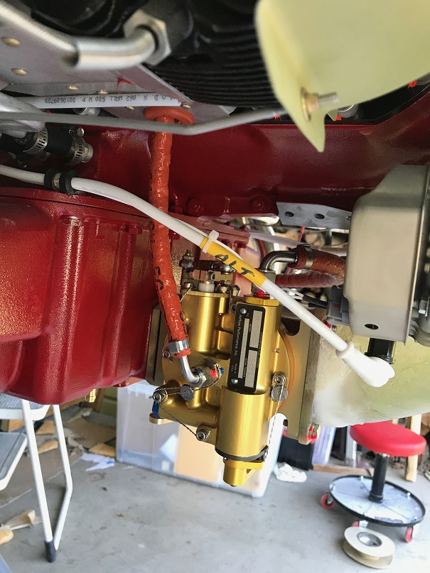

Mixture control cable-exhaust pipes
Has anyone run into this issue and how did you resolve it? Photos would be great!
After installing the Air Flow 390 bracket kit I noticed that rubber coated mixture control cable is literally laying directly on top of the exhaust pipe a short distance from the bracket plate. The heat from exhaust pipe will quickly cause an issue with the rubber coated control cable. Additionally if the cable is bent upward 90 deg to avoid the hot exhaust pipe in this short space, I anticipate the bend will cause the control cable to bind and hard to operate.
Note the my exhaust pipes are standard from Vans, not the optional Vetterman pipes like I believe Chris Moon has on his RV14A in this thread.

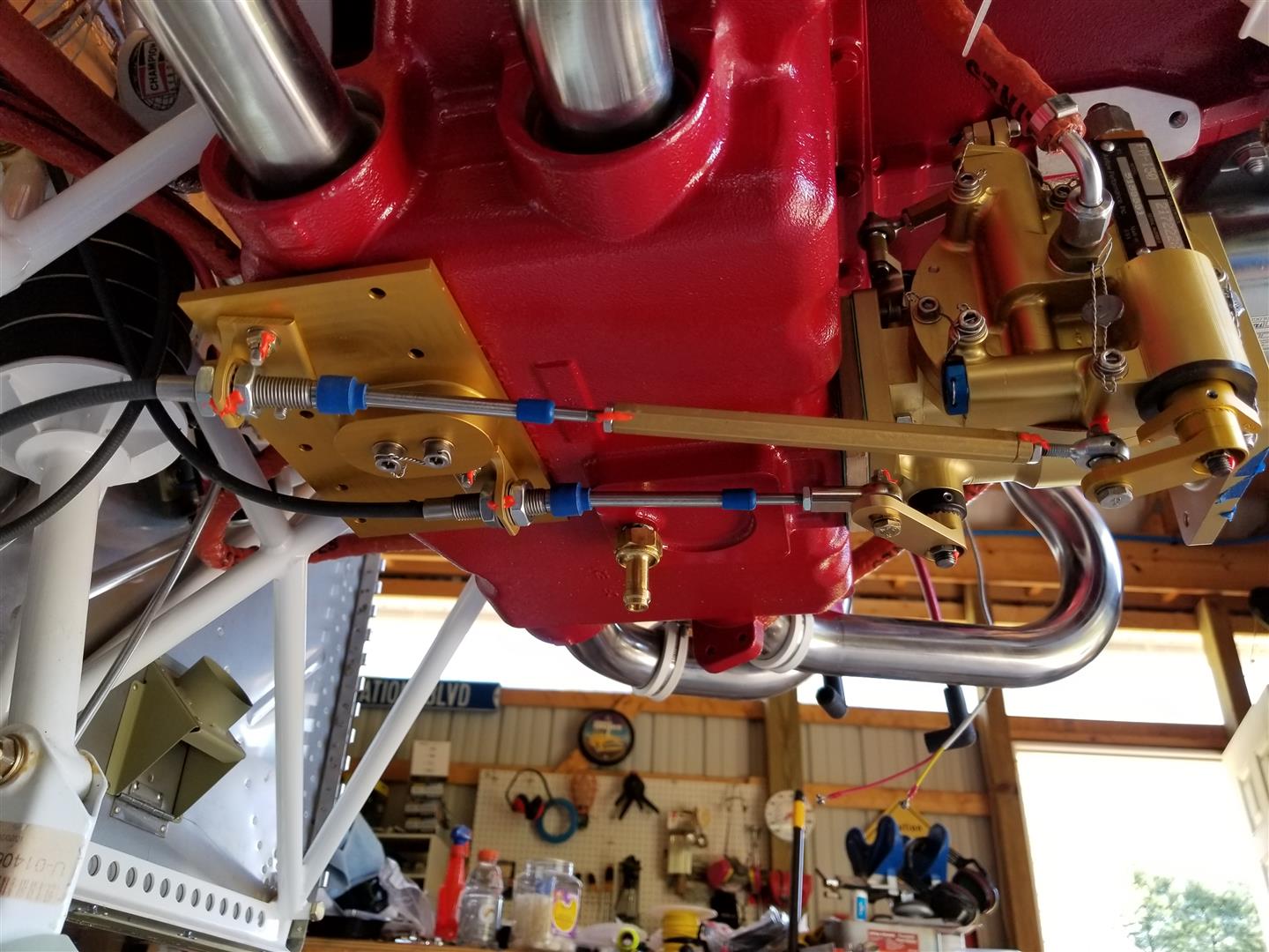

I am about to install the FM-150 and I have a question. I assume that one needs to buy the following kit from Airflow performance.
https://airflowperformance.com/index.php/product/throttle-mixture-cable-bracket-kit/
This will have all the parts need to put on the FM-150 and the parts to hook up the controllers. Is there anything else I will need.
My real question is why did this kit not come with the engine from Lycoming? Or was I supposed to get it with the engine? It is confusing to me that this kit was not included from Lycoming when purchased.
The other thing you will need to do is modify the snorkel. The FM-150 servo needs a spacer between it and the engine to allow throttle and mixture cables to move through their full range. This moves the attach point of the snorkel forward from the standard Van's location. Look up Nova RV's excellent post on how to modify the snorkel (here: http://www.vansairforce.com/community/showthread.php?t=162451). I used this method and it worked well - I found the easiest way to get it right was to mount the snorkel while doing the first round of modification, get the position tacked into place with some strips of fiberglass, then remove and finish up. Of course this took many rounds of shaping and fitting as per usual. I put some photos here: https://turnerb14a.blogspot.com/2019/01/firewall-forward-work-starter-switch.html.
Final note on snorkel: I had to cut a lug off my starter to clear the snorkel, but I switched from the standard light-weight starter to the "NL" version (Jeff at Thunderbolt mounted for me prior to shipping) so may not apply in your case. It's not hard to do - I just used an oscillating blade type cutter and then ground it down/smoothed it out. Instructions are included in the starter manual IIRC.
Also - once you get the kit to mount throttle and mixture cables, carefully look at the routing of the cables - especially mixture - with exhaust in place. I had to tweak the mixture cable routing to keep clear of exhaust and used both firesleeve and one of Antisplat's heat shields to protect that cable. Also had to adjust the throttle and mixture arms on the servo to clear the rod ends and get full adjustment range on the controls - easy to do but lots of tweaking. Important note: the photos on my blog are not the final mounting locations - I was able to move the rod end to top of the arm by tweaking the arm angle so the photo in the post above is not how it ended up. I didn't like the angle of the rod end from the mounting plate as shown in photos on the blog.
As far as the "why" the only thing I can suggest is that some builders may want to take their own approach to this - like ordering different cables, etc. Note my mention of the mixture cable routing: if I had thought about this more before mounting the exhaust, I might have ordered a different length cable and routed it differently. It worked out fine but took some work to do.

To take off that fitting would require taking off the spider fitting. Can you get caps with safety wire holes drilled in them? Do they come that way in general? Or do you have to drill yourself?
The other question about safety wiring the cap. If a cap has to be safety wired, then why don't all the hose connections? They are the same compression fittings. Just curious.
Ken---used to bavle to get the caps with the safety wire holes already drilled. Havnet used them in a long time---so I'd have to look. In early days of aviation, all the hose connections were wired. More modern fittings generally are not----but some warbird stuff we do are.

It appears that the two difference setups put the throttle bracket in different spots. The one as per the Airflow Performance puts the threads of the push cable at the end of the threads (or so it seems), while the other picture by chris puts the bracket such that the threads are in the middle. Any pros and cons to the difference in the bracket placement?
Ken, if you do as per the printed instructions there will be fewer threads to go inside the threaded rod end than if you flip that mounting bracket around. I counted and it's 8 turns vs 18 turns captured and to me was a much safer installation.
SO I mounted the FM 150. I was able to torque down the 2 on the left side using a crows foot, but how the heck do you torque the top right nut (co-pilots side) and the bottom right. I looked up a 3/8 torque wrench to 1/2" box wrench extension.
https://www.amazon.com/Stanley-Prot...ix=torque+wrench+adapter+1/2",aps,159&sr=8-46
But this will not work because the box wrench won't fit over the nut, since the space is so tight.
I must be missing something simple, but I can 't think of it off hand.
And taking the studs out was very easy with a $13 stud remover from AutoZone.
