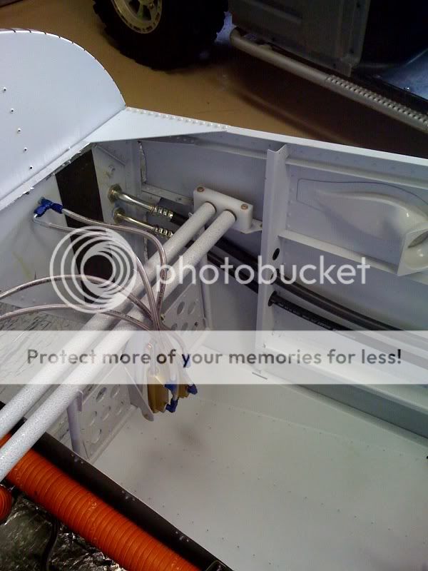

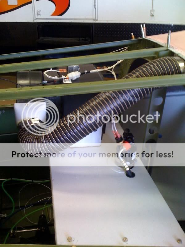

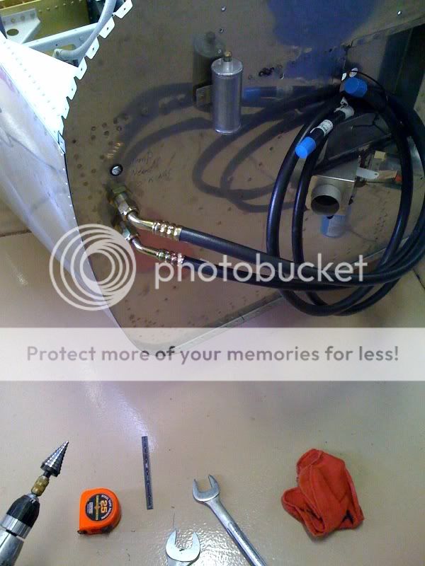

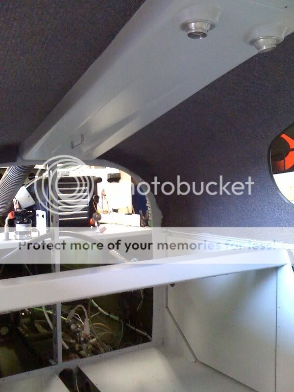

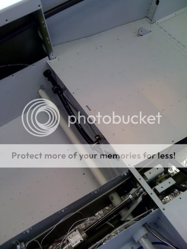

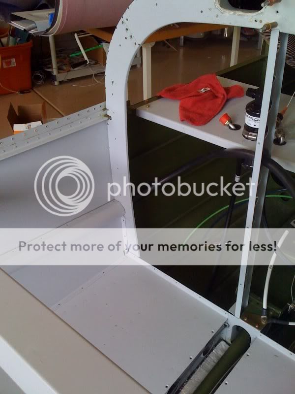

If anyone is interested, here are a few pix of my A/C install. I didn't want to add a hot line to a hot center tunnel so I ran the lines down the FO side as much as possible. I did have to glass out a flare in the cargo side panel to allow the thicker return line through. The hardest part was chasing down all the proper sized grommets and snap bushings.
