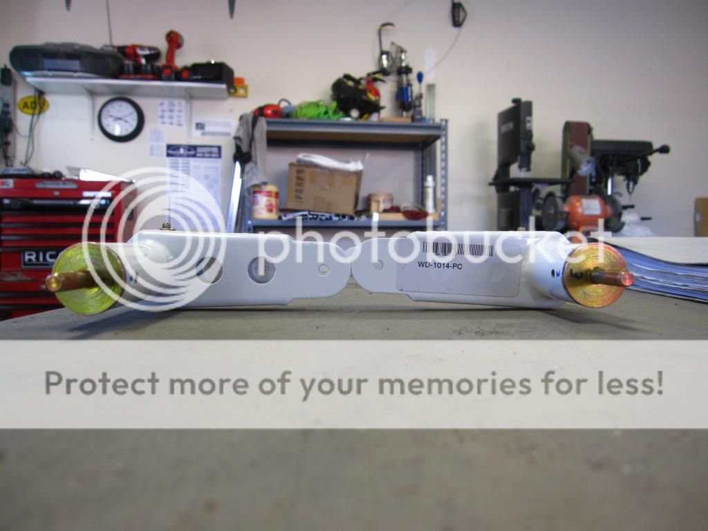

When drilling the aileron torque tubes, the plans have you shim fore vs. aft 5/16". Measure twice, right? Well... when I checked things after drilling, this is what I found:
My fuse ships in about 2 weeks, so no big deal having another length of tubing thrown in the crate - will be a quick job to cut and drill. Just wondering if there is any room for adjustment for this mismatch. I'm not really seeing how there would be. TIA!
