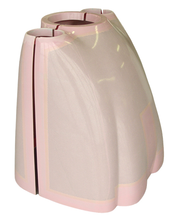

Not sure about "proven" but here is the only after-market cowl I've seen on the market. I don't have experience with it but came across it the other day.
http://www.showplanes.com/ecom-prodshow/EC_10.html
Optimized design for cooling airflow...
RV-10 cowling features circular cooling air inlets using the bottom 25% of each inlet for engine induction air. Manufactured using the latest composite material technologies, the cowling is ultra light weight and more rigid than a standard wet lay-up.
Flight tested and designed to utilize a fifteen-inch spinner with a proprietary nose gear fairing for optimal cooling. Engine compatibility includes standard Lycoming IO-540 series and BPA cold air induction engines. Order now and optimize your RV-10 engine cooling with this all new low drag cowl.
