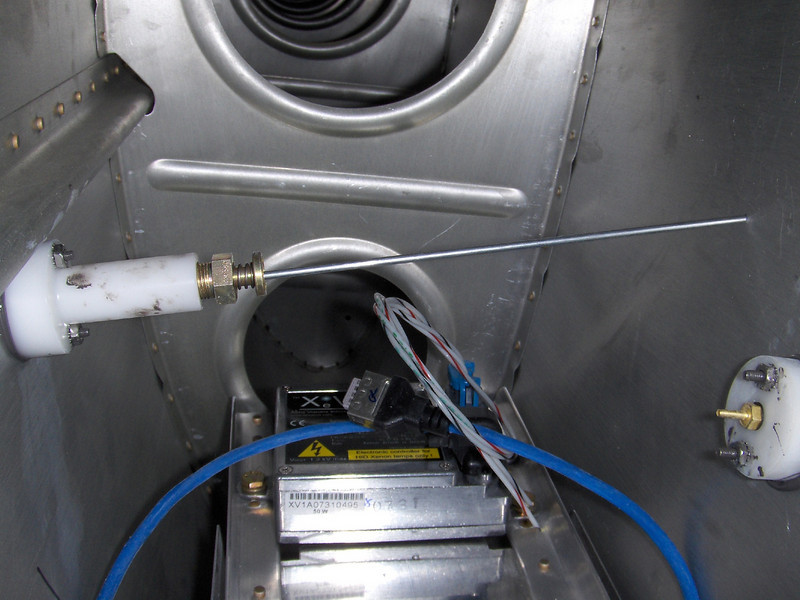

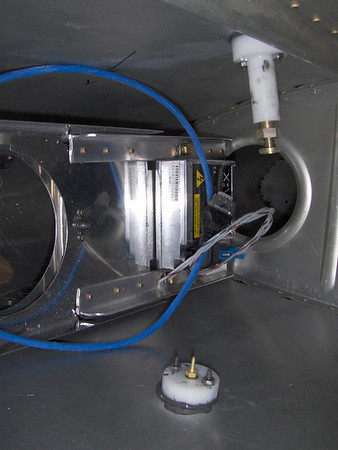

How hard is it to find the purge valve with that pin moving around inside the wing with no visual? Also does this mean water just drips into the wing area?
Daryl,
Yep, I think it'll be interesting. I'm not flying the 10 yet and don't have an AOA on the 7A so not sure how it'll all work. There are some other posts on this site that discuss how little if any water has been found in the ports. These are extremely small holes. Any water will drip into the wings.

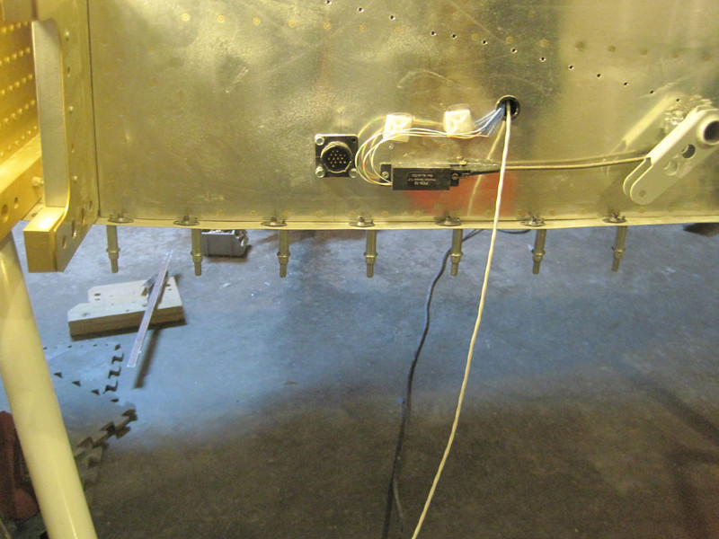

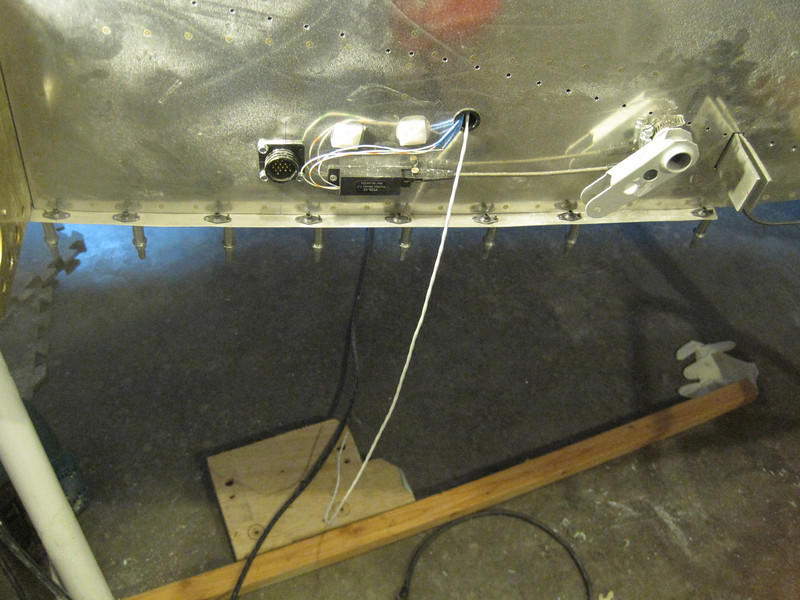

and here's a couple pics of the POS12 used as a flap position indicator....
I stole this location / idea from another poster on this board some time ago
