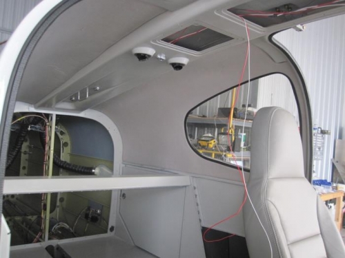

Mine
Here is a decent pic of what I did, then I just slid the upper half of the rear bulkhead panel under the weather stripping, voila. IIRC, the weather stripping was the same stuff that goes on that little panel under the HS where it joins the fuse:
I don't think I've had to take off the upper half of the bulkhead panel since it was installed. Access to the empennage only requires the bottom half be removed.
That looks good. One problem is that there are two screws (at least in my setup) holding the upper panel that ends up covered by the overhead console. I think you are correct that the need for removing upper panel is low, but you know, I am getting stiffer and need more maneuvering space............ should I ever need to get into tail section!!
I like the weatherstrip seal. Simple solution

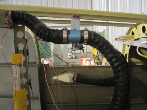

NACA vent controller attachment to bulkhead
I received the NACA vent yesterday and noted there is no attachment bracket on it for attaching to bulkhead. Just the two tubes. Keen to see how you attached the controller to bulkhead.
Thanks.
Johan

Mark,
Are you referring to the rivets that attach the NAVA controller to the bulkhead?
Thanks.
Johan

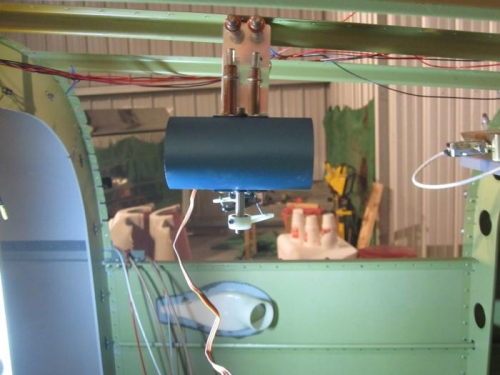

The controller needs to have a mount fabricated for it. I mounted mine from the stringers overhead. The bulkhead needs some scat flange adapters. Then you use a scat tube from those to the controller and then another set I scat tubes from the controller to the vents themselves.
I suspect your confusion is you believe the controller mounts to the bulkhead. It doesn't.
Mark,
That's exactly my confusion.
Will order scat flanges from VANS.
Thanks.
Johan
I just fabricated a bracket to mount the valve to the j-channel
Scat tubes run to scat flanges on the bulkhead
You can see what Mark is talking about in this photo:
I mounted the flanges, then realized the issue with riveting the cabin cover. I ended up just using some blind rivets in the couple locations that I couldn't get a bucking bar to fit. It all gets glassed over, so not a cosmetic issue.
The flanges are from ACS

I can't recall for certain, but I think I just had to move those two nutplates a short distance outboard to clear the OHC. Even though I haven't had to remove the upper part of the aft bulkhead, I don't think it would be difficult as it slips underneath the weatherstripping pretty easily. FWIW.
Also, I did not install a bracket to hold the NACA valve. I attached it to the hose flanges with much shorter (3-4") hoses than shown in Bob's picture, and secured the long hose runs to the NACA vents. The end result was that the valve assembly is very rigid. As light as it is it doesn't seem to be a problem.
