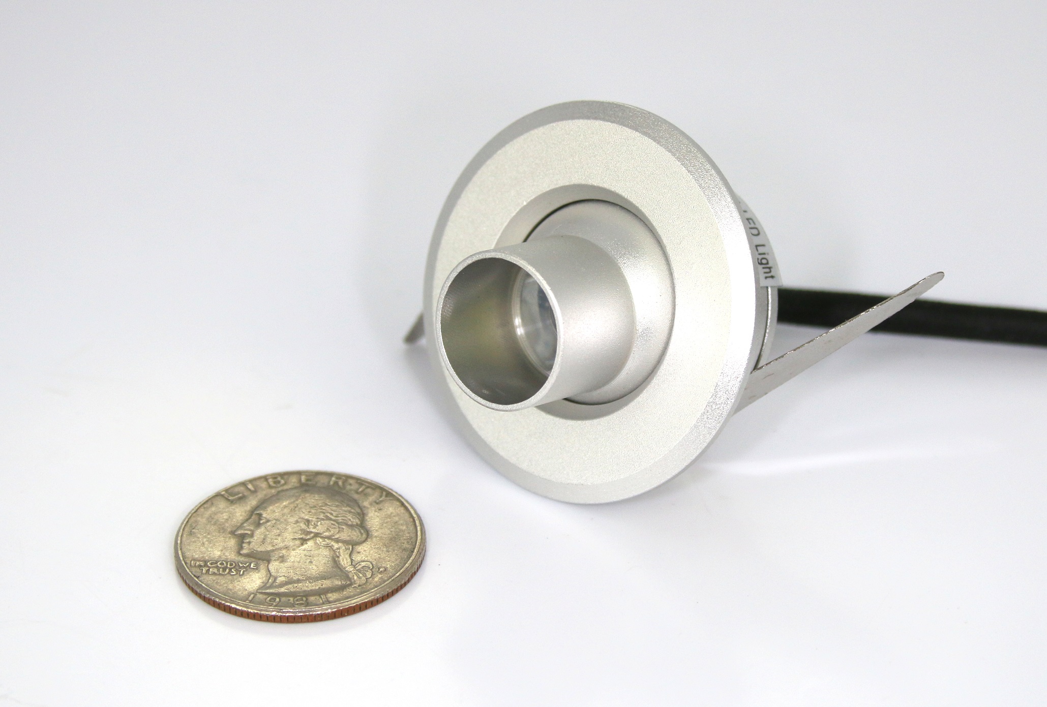

I had to look them up again but here are a few good lights.
This is similar to what Cirrus uses:
This company also has some small eyeball lights. (Install pictures are an RV-10 :) ):
These are from Pilotlights.net. ( I have no affiliation to this company)
There are also great uses for light strips. The great thing about light strips is the indirect lighting they can give. The color can be controlled.
There are also the Beechcraft lights like these:
baron-int-details-1.ashx
everything but the LED strips will take a bump or overhead console.
