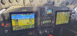

I have been meaning to post images of my upgrade of RV7 with my new AFS IFR panel.
Some likes on AFS
If you get a dual AFS EFIS system you have 10 serial ports.
Dynon has 5 ports on a single or dual installation. It can make a difference if you have more than 5 serial devices. I ended up using 9 ports.
ACM electronic circuit breaker control panel.
Designing was easy with there quick panel service. panel preconfigured and was a drop in replacement. All my input device , ADHRS, AP, audio, comms, nav, IFD, ADS-B etc worked on 1st power up.
Great documentation and support.
I choose a IFD 440. I used a Garmin 375 in my IRF trainer. I like the IFD 440 much better so far. Then menus are intuitive and fast to navigate.

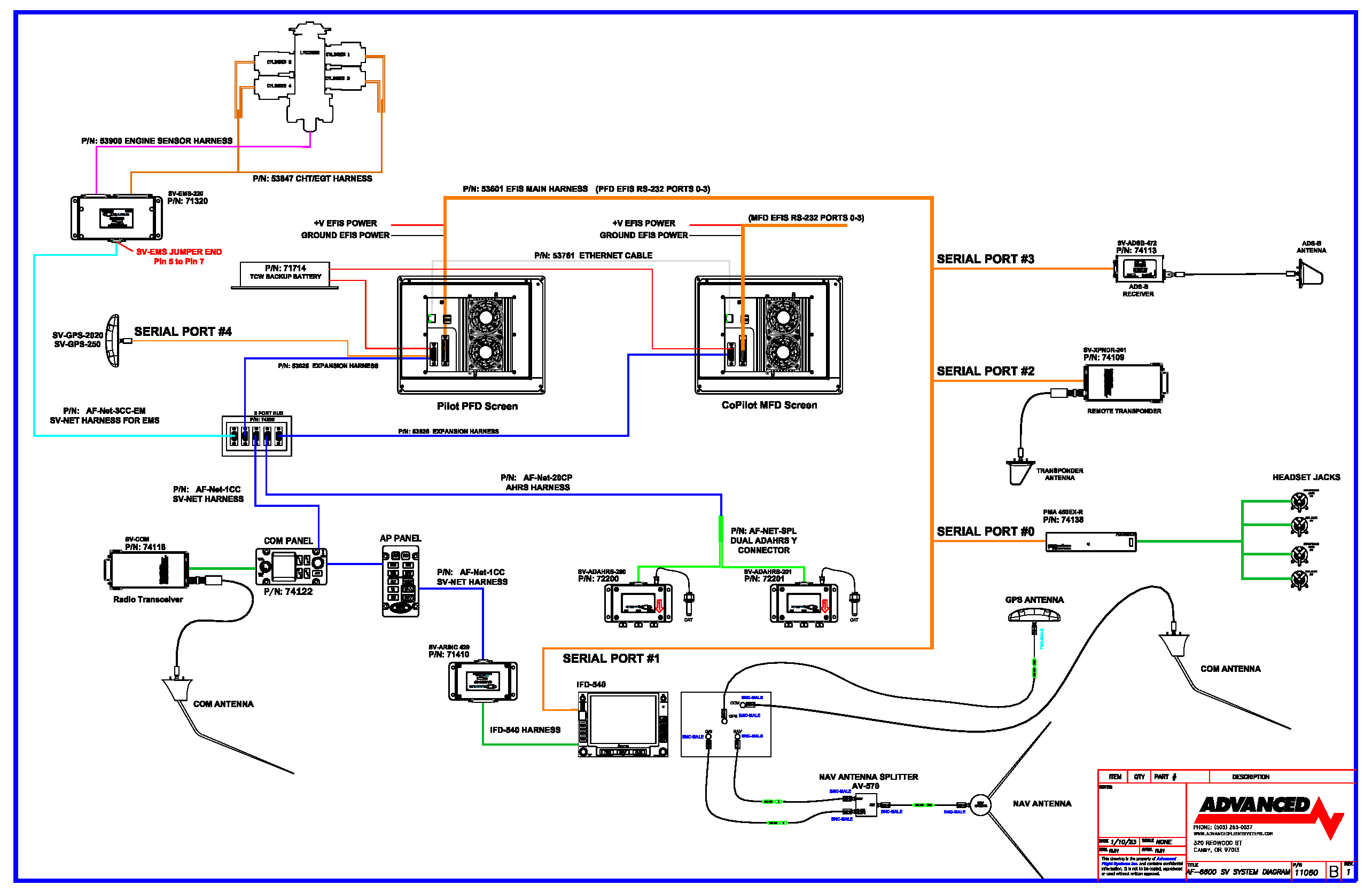

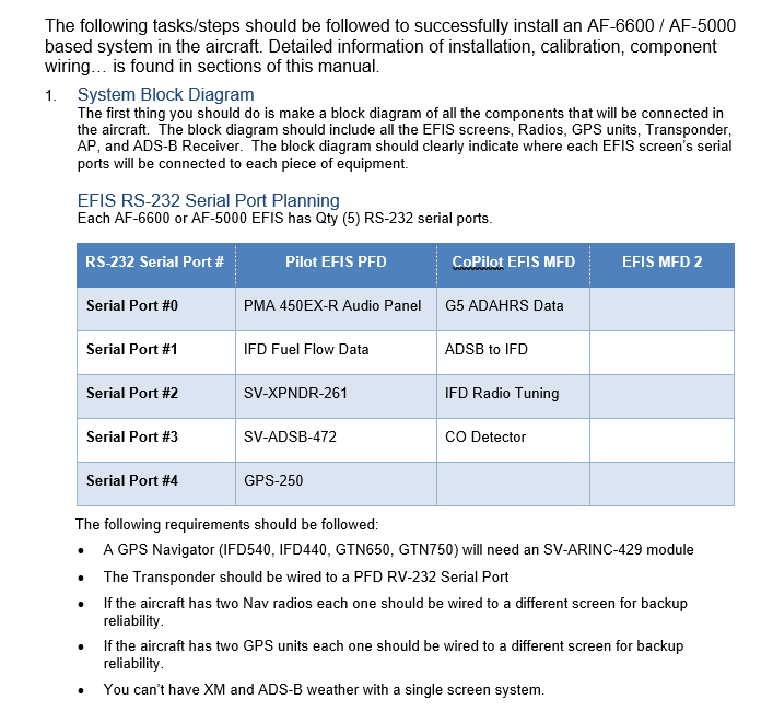

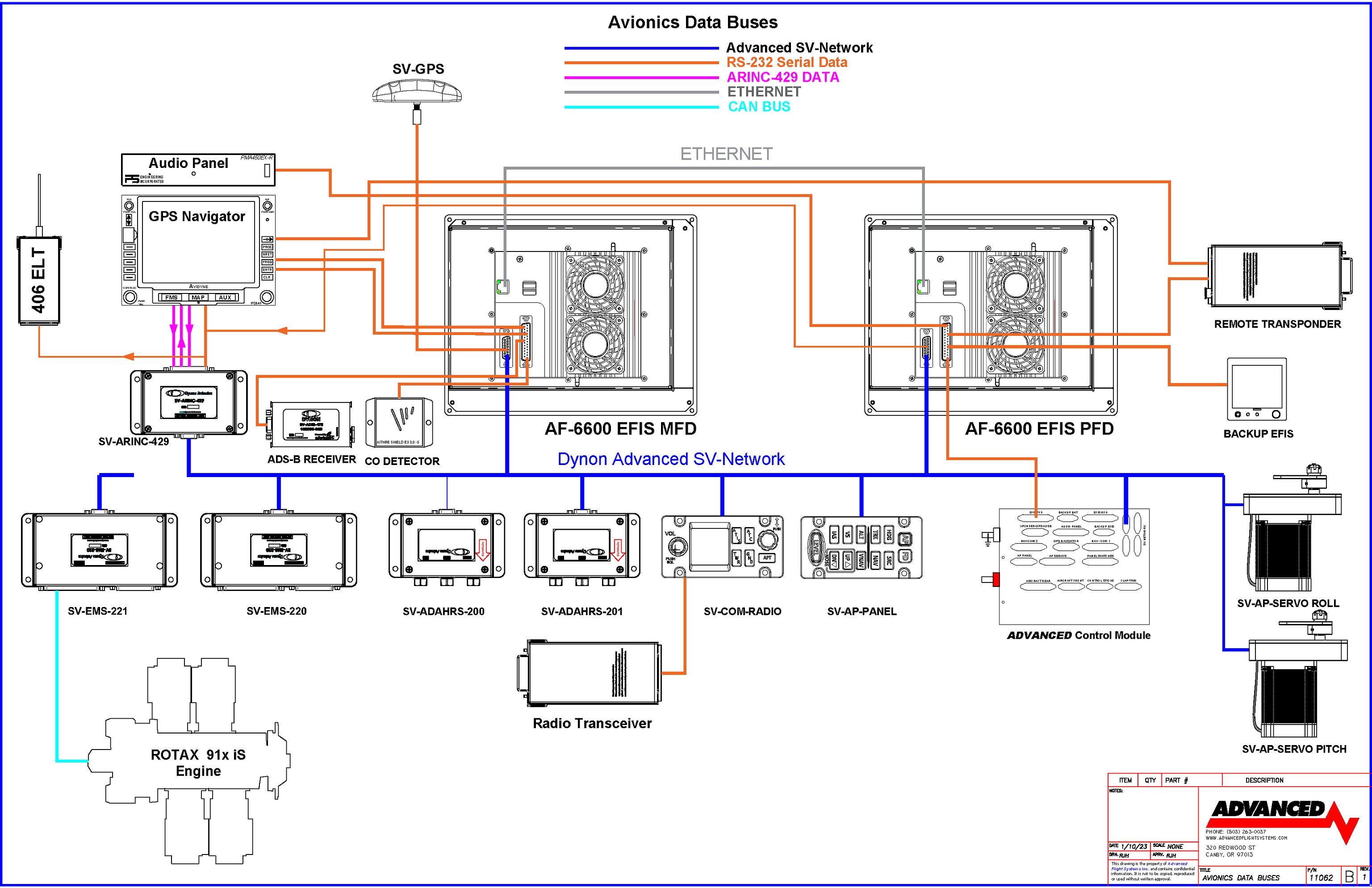

Would you mind going through what accessories used the serial port inputs in your case? Trying to gauge what I need to plan for…

The example Rob shows is just about identical to my serial devices
I have a AV30 instead of G5 as backup
