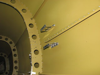

Is there a photo of the mounted ADAHRS on any ones web site
Can I add nutplates to the Brackets before riveting them to the tailcone.
Yes, you can. The flange is a bit narrow, so you might bend it a bit, but not too bad and you can bend it back. I had originally installed the brackets without doing anything to them and then later realized how awkward it would be to install the ADAHRS in the back, fiddling with the unit, the screws and those metal lock nuts. Yesterday, I drilled it out and installed nutplates K1000-06 and put the brackets back in.
The only photo I have is from the original installation, not sure if that helps you.
The link to the full post is here (including a link to a larger image). Picture is on the bottom of the post.
Dynon says to use non magnetic fasteners which may have effect on the compass. I used stainless steel bolts
Not all stainless is "non magnetic" you must realize.
Now you got me worried about putting those big ol magnetic steel nutplates up there like that! I know others have had some real problems with the unit from magnetic steel located nearby. Think I will stick to the plans on this, and confine my experimenting to other areas.
Didn't think about the magnetometer in there. Another option would be to install the ADAHRS before riveting those brackets in. Plug up the threaded holes until the hoses get connected later.
You will have to do THIS anyway to connect the tubing...
I found it easy to just apply the hardware in the plans.
And you will have to "assume the position" again if you ever need to remove it. Or maybe you can find a skinny kid that can get through the split bulkhead (see Modifications sticky) so you will not have to remove the tank...

Joe,
I did not use nutplates or platenuts because they're magnetically attractive. Dynon sternly warns about keeping anything ferrous or magnetic outside of a 2 foot bubble.
Here's my homemade ADAHRS shelf, mounted in the roof just behind the baggage compartment wall:
http://www.mykitlog.com/users/display_log.php?user=scrollf4&project=879&category=0&log=147364&row=5
I used brass nuts/screws/washers (Ace Hardware) and aluminum adel clamps (Spruce). I had the same concern about accessibility you mentioned. Therefore, before I riveted this shelf in permanently, I cleco'd the top skin into place to see if I could get to the screws/nuts with an angle screwdriver and remove/install the ADAHRS. It wasn't a breeze, but it was reasonably achievable.
Hope it helps.

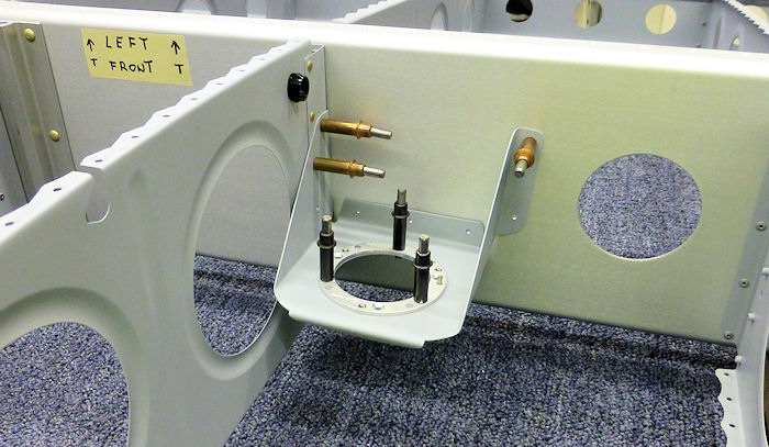

A old Problem in a new light
The Garmin GMU 22 Magnetometer
I talked to Garmin team X and I was told to use non-ferrous nutplates around the GMU 22
I am installing the magnetometer in the wing as they recommend.
The access panel will require nutplates.
Does anyone know a good source for non-ferrous nutplates
See Page http://joesrv12.com/Builder Log/bl_15_05.htm
Joe D

Here you go Joe, these are silver plated A286 cres. There is a lot of 100 listed on eBay now listing # 271978013946 but they are 10-32. The gent listing them said they would "not respond to a magnet at all". I could not find a MS35214 (plated brass) screw in 10-32 only 10-24 (-55) listed.
Jerry
MS21060-06 -- IS THE 6-32 PLATE NUT----
MS21060-06 Characteristics
MATERIAL: Nut and basket - A286 corrosion resistant steel per AMS 5255, or AMS 5732.
NOMINAL THREAD SIZE : 0.138 INCHES
THREAD QUANTITY PER INCH : 32
THREAD DIRECTION OF MS21060-06 : RIGHT-HAND
SURFACE TREATMENT : SILVER OVERALL
HARDNESS RATING : 49.0 ROCKWELL C MAXIMUM
NUT STYLE : A116 PLATE
NUT LENGTH : 0.948 INCHES MAX
NUT HEIGHT : 0.203 INCHES MAX
LOCKING FEATURE : PREVAILING TORQUE ALL METAL DESIGN
NUT MOUNTING PROVISION : STRAIGHT HOLES
TEMP RATING OF MS21060-06 : 800.0 DEG FAHRENHEIT
FEATURES PROVIDED : FLOATING NUT
NUT,SELF-LOCKING, 6-32
I will use them for the access panel under the wing at the Garmin GMU 22 Magnetometer
