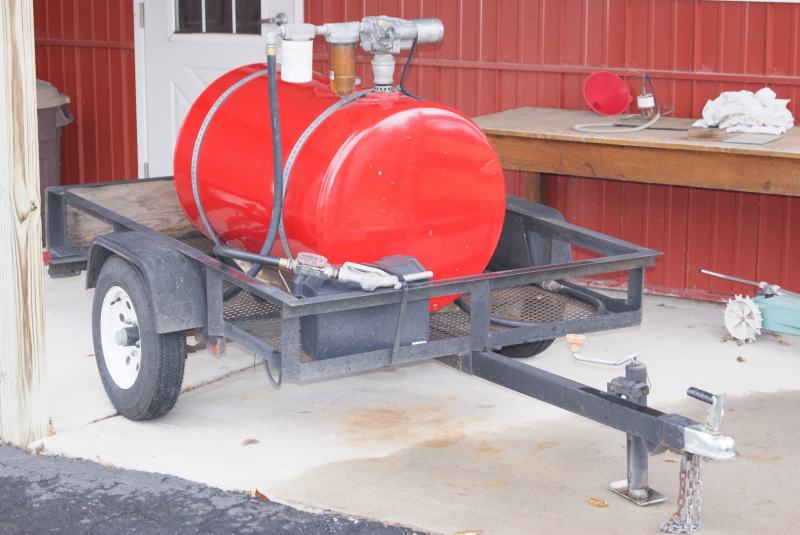

I made a commitment a long time ago to make sure my fuel is clean, dry, and fresh.
I have pumped about 6500 gallons of fuel though this baby, over hauled it 3 times. Change both filters every 6 months. My grandkids fly with me.
Very nice Larry, Details????? Where did that tank come from, capacity, etc.??????
The tank is an old 100 gallon diesel tank off an 18 wheeler. I bought the trailer, the12v electric pump, and the fuel meter new at the local farm store. I have two 10 micron water filters on the system.
I always run the fuel back into the tank to flush it out at the beginning of any flying day.
