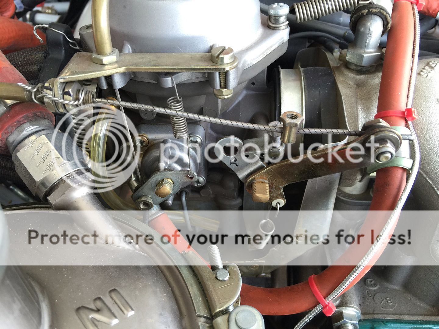

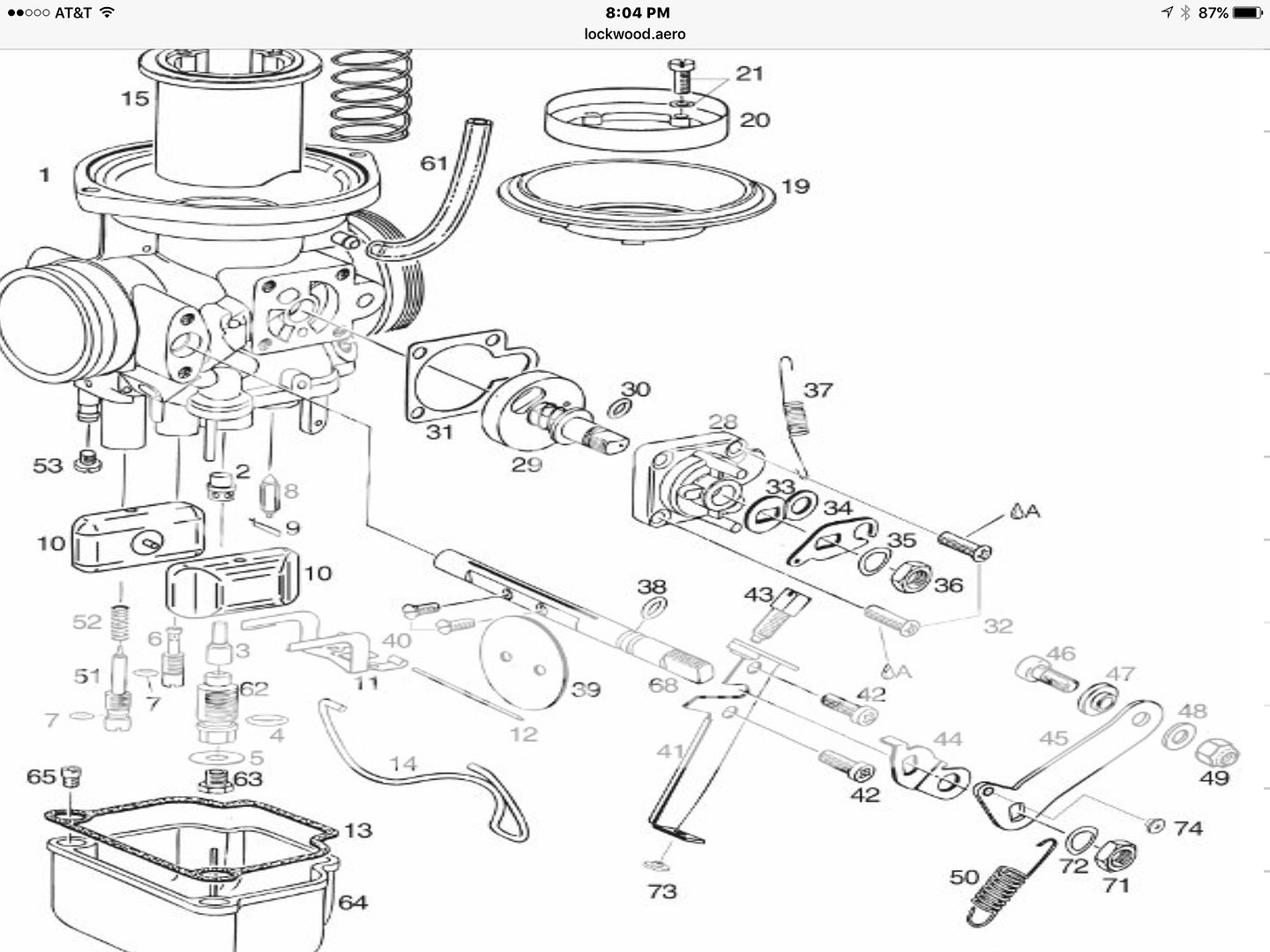

Just replaced those cute little plastic inserts in the carb throttle arm where the springs attach. See parts 74 and 73 in the first pic.
788 hours on each one.

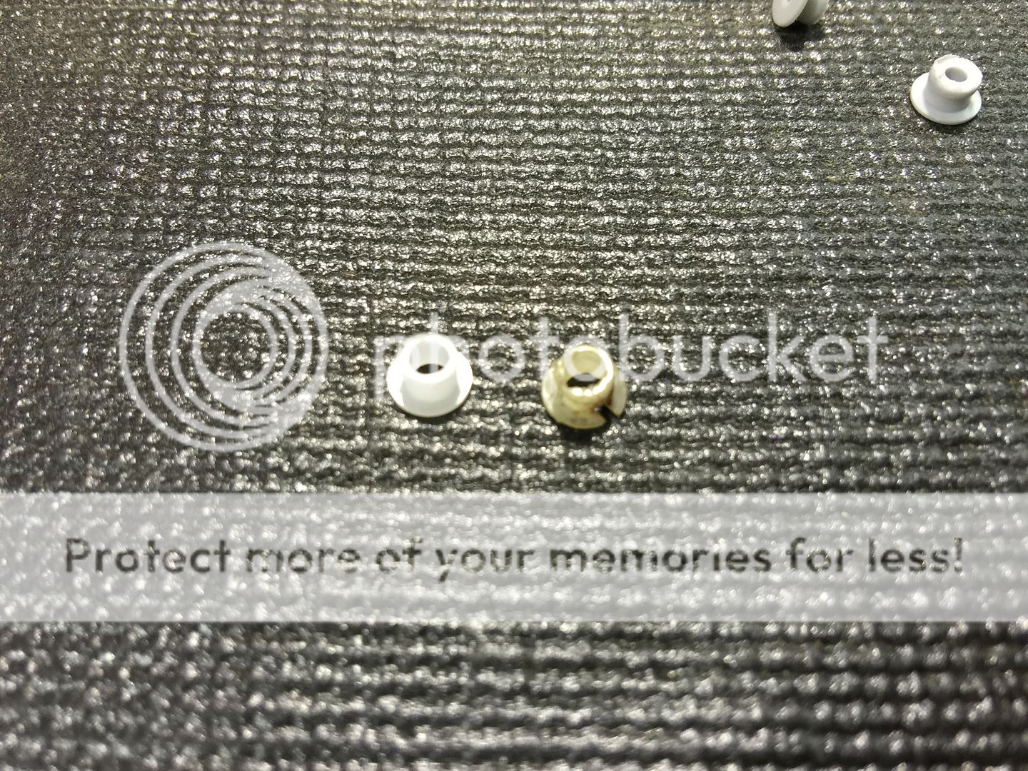

Part number 73. Old and new. Part 74 is shown in the upper right corner.
Part 74 on the Left. Can't show you the old part 74, because both were destroyed upon removal. Part 73 on the right, new and old.
