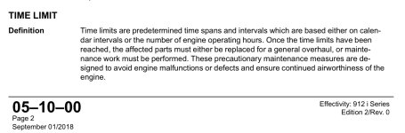

On G3X engine time is the same as the traditional aircraft tach time.
Rotax specifically states that all engine inspection and maintenance is to be done based on Hobbs time.

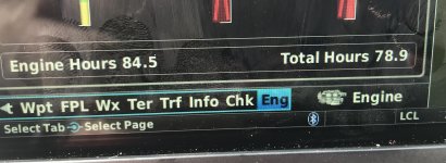

I think these screen captures from the Rotax Maintenance Manual Line agree with that statement…. But, a related question is does the Rotax FADEC provided “Engine Time” accrue like a mechanical tachometer where the ‘tach time’ isn’t equal to watch time except at a certain RPM -OR- like a hobbs where it records watch time once it’s powered from a sensor (oil pressure, master switch, wow, etc)
Thanks!
-Jim
P.S. Added a picture of our RV-12iS times from a couple weeks ago…. The G3X is set to record Total Hours using the airborne option (i.e. GPS and IAS derived).
