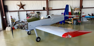

A data point. My hangarmate taught himself to paint. Here are his expenses to date (from him this morning). A few vinyl stickers and his TX-themed RV-8 is done.
v/r,dr
"Air Compressor and drying equipment- $3500. I went too big
Paint booth - $3000
Paint- $1500
Supplies - 800
Sweat and heartache - ouch
Learning experience- priceless"

There is something to be said about “yup, I painted her too!”
Did he paint it in the hangar? I mean did the (I assume) inflatable booth go inside the hangar? Like others have said, finding a place to do it is a big issue, esp here in socal.
In the hangar down the road at our airport that had more room. It was a blowup paint booth held by positive pressure. Massive filtration system - when you’re done with it you turn off the switch and it collapses down to the ground, but in his case, he built a small wooden frame on the inside that it would fall down on allowing him to still go in and out.
It was something like this:
Yep it can be done and not that difficult, the key is the prep, the better the prep the better the finish. I didn’t spend half that $ though .

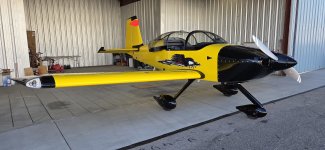

Not a typical scheme. I sprayed the black in my barn. Yellow is vinyl. In a couple years, I will peel it off and change the color. That's why the painted stuff is black. I may have a custom scheme printed. Between primer, paint, cut & buff supplies, vinyl and tools for both, I probably have $3K invested. I did buy a HF Black Widow. Next color change will be less than $1500 since I have everything.
