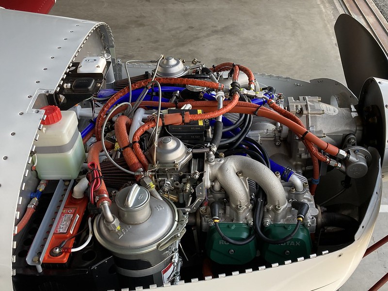

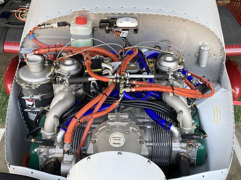

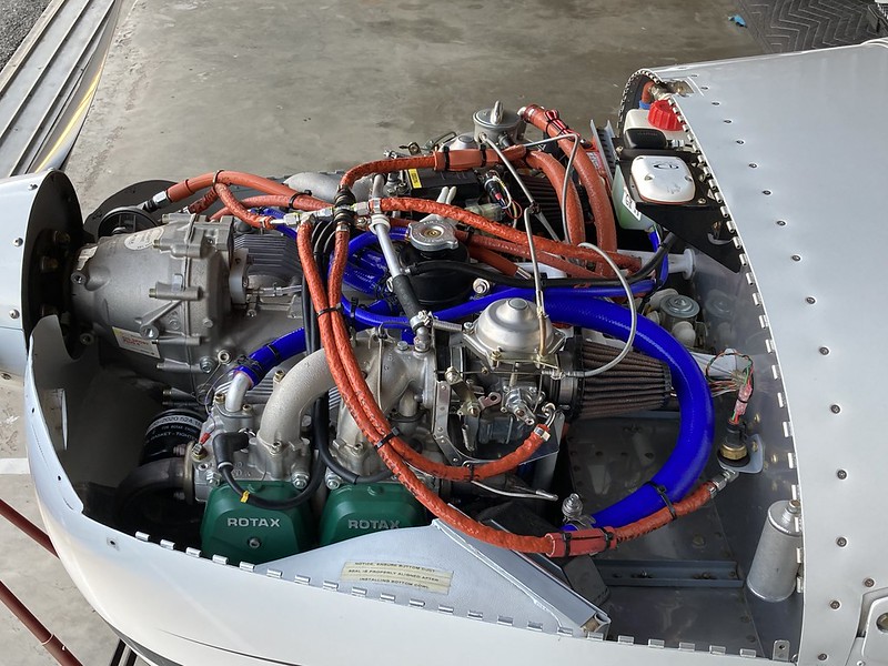

All the critical hoses have now been replaced, The blue are silicone for the coolant.

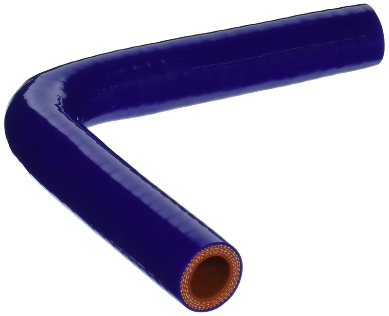

HPS 1" ID Blue High Temp Reinforced Silicone Heater Hose Tubing, 25mm ID Part Number: HTHH-100-BLUE
HPS 5/8" ID, 10" Leg, Silicone 90 Degree Elbow Coupler Hose, High Temp 4-ply Reinforced, Blue, 16mm ID Part Number: HTHH-062-BLUE
HPS 5/8" ID Blue High Temp Reinforced Silicone Heater Hose Tubing, 16mm ID Part Number: HTHH-025-BLUE
HPS 1/4" ID Blue High Temp Reinforced Silicone Heater Hose Tubing, 6mm ID Part Number: HTHH-025-BLUE
Do not use worm clamps on silicone hose they will damage the outside. I used this type for the 1” hose, they have an inner band to protect the hose and are spring tension to keep constant clamping force. McMaster-Carr 54205K17
The vans spring clamps fit on the 5/8 - 16mm silicone hose except the 90 degree one, it is a slightly thicker wall, get these clamps instead. Constant-Tension Spring-Band Clamps for 1-1/16" OD Hose and Tube. McMaster-Carr 7329K16
These same size hoses come in black, blue, red, clear.

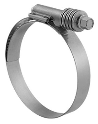

I replaced most of my ROTAX spring clamps with screw type. A few don’t have enough clearance to adjust in place, so I left the spring clamps in those spots. Mine have been in place 4 years since there replacement. I did get a little movement on the screw at the first annual after replacement. Probably the rubber compressed and deformed a little. Subsequent annuals have shown no further adjustments.
The spring (also referred to as constant tension) clamps are used for a very good reason on the Rotax engines.
All of the fittings the hoses attach to are made of aluminum. Aluminum has a rather high thermal expansion coefficient.
That means with temp changes, the fitting will be expanding and contracting within a fixed diameter clamp if screw type clamps are used. Over time this can compress the hose enough that leaks start to develop because the clamping pressure of the clamp has actually reduced (that is why with the passage of time, this type of clamp is often found a bit loose).
The constant tension clamps can expand and contract slightly with the hose and fitting, so the integrity of the seal is un-effected
This is why people that know, have switch to using constant tension clamps on Lycoming engines, even though screw clamps have been traditionally used for many decades.

Depending on the hose you use you may be able to reuse the Rotax clamps. The 90 degree hose I got was thicker wall so I needed a bigger spring clamp from McMaster Carr, #7329K16.
You MUST use constant tension clamps or expect leaks, The spring clamps look cheap but they work good.
Don't use worm type screw clamps on silicone, the "worm" thread eats into the silicone and will tear the hose. There is a special type that has an inner band to protect the hose AND spring tension on the screw. It uses Belleville washers on the screw to maintain constact pressure during thermal expansion. McMaster-Carr #54205K17. I use these on the 1" hoses.

If you get the HPS 90 degree hose I specified, the 7329K16 clamp is a perfect fit. These clamps do not have a lot of range, they are designed for one diameter only while giving just enough squeeze tension.
The HPS 90 degree hose is only slightly larger in OD than the OEM hoses. The OEM clamps could be opened far enough to fit but they would not clamp properly if you did that.

I used everything Seagull provided in the post and it went well. Getting off the original stuff was the challenge. I ended up cutting off most of them.
