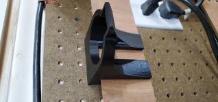

Does anyone have info or a link to the 3D printed holder for the Bose a20, that mounts in the Rv-10 console lid?
It held two Bose controllers and was mounted to the underside of the aerosport console lid.

Really would like a talented person to draw this up in CAD for a 3D printer.

Great idea but not the one I was trying to find. The one I am looking for was 3d printed and mounted on the inside of the console lid...
