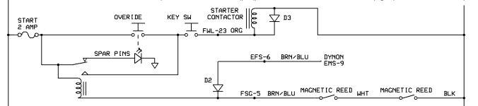

Bob, I think you are looking at the wrong diagram.
Since you said you have a D-180 equipped airplane you would need to use this diagram - https://www.vansaircraft.com/wp-content/uploads/2019/01/D-180-Avionics_03-22-17.pdf
I have attached the relevant portion of the diagram below. Note that the two double dashed lines I circled in red are identifying the two different pcb portions of the switch module (I.E., everything within the boundary of those lines is on or directly connected to that pcb portion of the entire assembly). Don't use this for reference because it will be difficult to read because of the low resolution. Download the diagram using the link I provided.
The anchor nut that has been mentioned is the thin nut that threads onto the key switch to mount the key switch into the panel face of the AV-12 switch module. So when viewing the face of the instrument panel from the pilots seat it is on the back side of the switch module face plate, so it can only be seen by removing the top fwd top skin of the fuselage.

Only opened the left spar pin. Will also try left and both tomorrow. Thanks for the schematic. I really have trouble with figuring anything out from the Van's schematic. Bob Kibby
Just re-read your last post and reviewed your schematic. I don't have the Dynon-180 installed! I'll install the D-180 this morning and retry. Bob Kibby
Installed D-180 and have all electrical connectors connected.
Both spar pins in: Spar Pin light flashes when Master is turned on or off. Starter engages when key is turned on.
Left spar pin out: Spar Pin light flashes when Master is turned on or off. Starter engages when key is turned on.
Right spar pin out: Spar Pin light flashes when Master is turned on or off. Starter engages when key is turned on.
Both spar pins out: Spar Pin Light is on and bright red when Master is on and red light goes out when Master is off. Starter does not engage when Master is on and key is turned on

Your results appear as if the spar pin microswitches are wired in parallel instead of in series with each other. With the master switch off, if you can remove both spar pins and clip an ohm meter or continuity tester across the terminals of one of the microswitches, then manually actuate each microswitch individually. If the meter or tester shows continuity when you activate each switch, they’re wired in parallel instead of in series.
Good catch Bob Y. I had assumed that the spar pin switches were wired
correctly because the plane has been flying for many years.
If the switches are wired in parallel instead of series, all of the test results make sense.
So Bob Kibby, all you have to do is wire the magnetic reed switches in series per the diagram in post
#41 above and your problem should be solved. And thank Bob Y.
